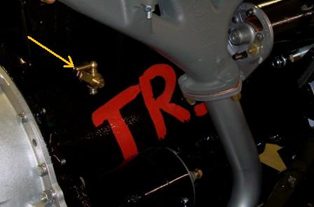

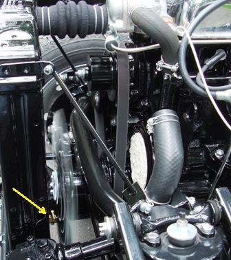

This is an excerpt from my post on the UK TR register forum.
<span style="font-style: italic">George: Yes, it could be that simple. However, here is something else to consider. From your photos, it appears that your car was restored recently. I will assume that the parts came from one of the three major suppliers here. We discovered while testing my 3A for coolant leaks that both the engine block and radiator drain cocks leaked. The leak was not at the threads where they thread into their bungs. They actually leak right past the seats, enough to make a large puddle overnight. We ordered three new drain cocks, one from each of the major suppliers. They were all identical and they all leak. In order to maintain genuine appearance we soldered a plug in both drain cocks and replaced them. When we need to drain the system we will merely remove the useless drain cocks and empty the system for flushing , etc.
Sorry to go on ad nausiam, but perhaps you are losing coolant in this way.</span>

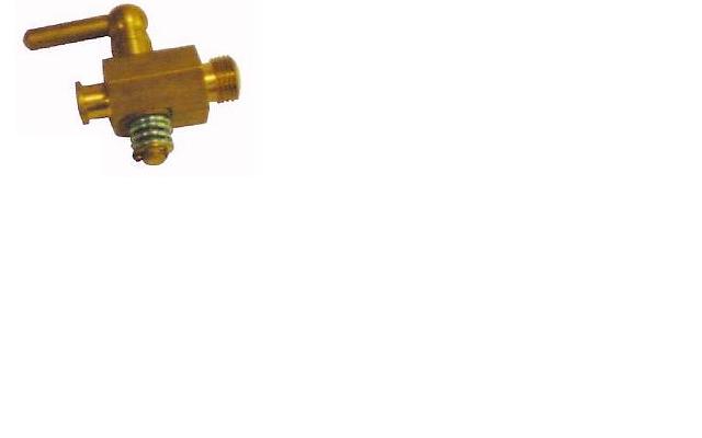

From this link, can you tell if the tap sold by Woolies is possibly better?
Drain tap
I recall some earlier discussion somewhere that a leaking tap may be fixed by lapping in the valve, but I've not had to do that. On my TR4, my block is pretty plugged up, so I never see a leak on that side tap!
