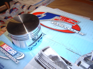

Pistons - at what compression is it recommended that a TR6 needs uprated pistons?
