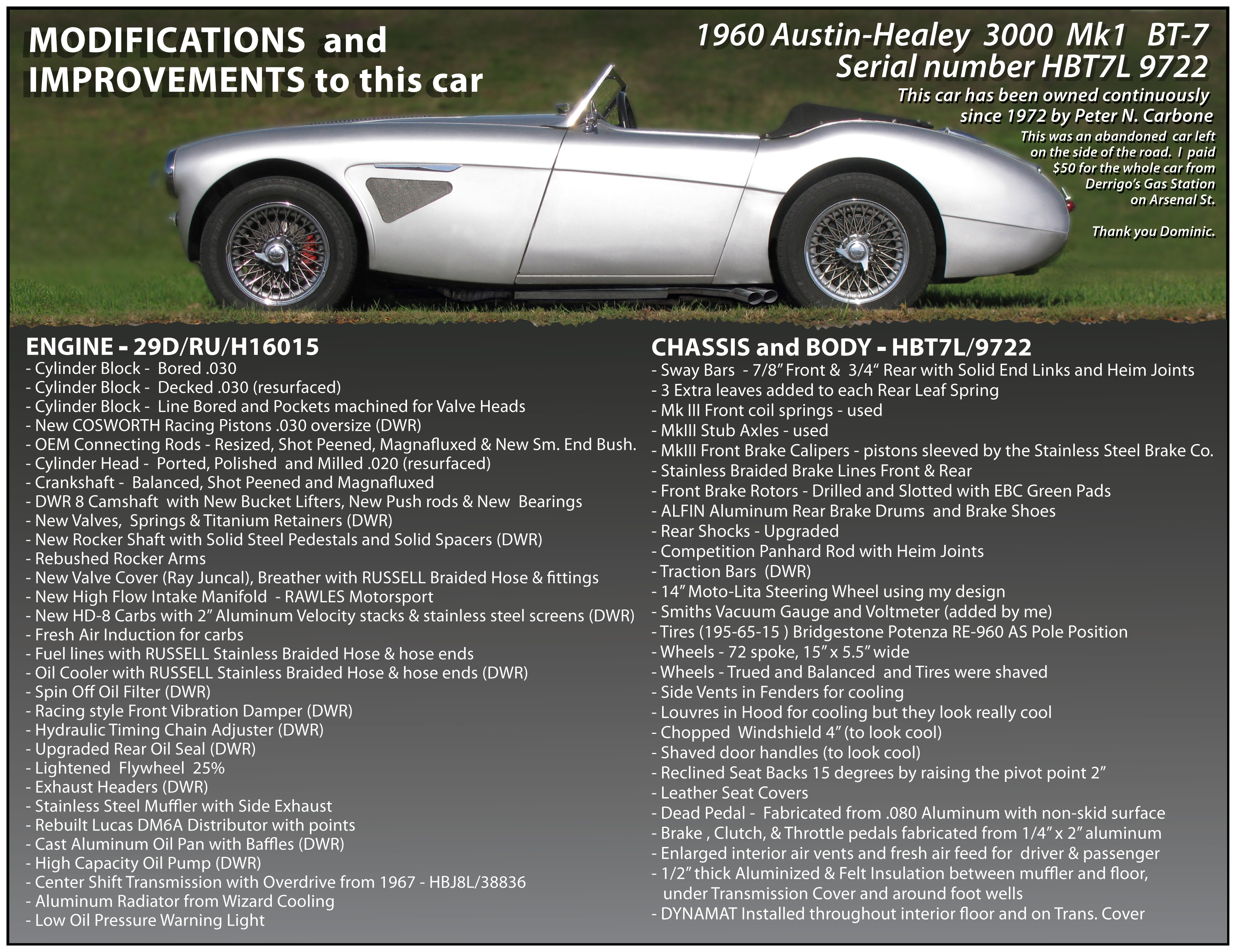

Hi Guys,
Just for the record I'm attaching a list of the modifications I've made to my car.
Hopefully these will come in handy for anyone considering updating their car or engine with time tested modifications.
Geoff Healey once said it was okay with him to improve all aspects of the car whenever you could.
I've taken that to heart and have accumulated over 40 pages of modifications on my car.
I'll post these from time to time in case someone else might be interested in topics such as:
- Rear Sway Bars
- Scoops for fresh air behind the grill
- Breather Hose Conversion
- Cold Air Box for 3000
- Third Brake Light
- Dead Pedal
- Wider Throttle, Brake and Clutch Pedals
- Optional Mounting Bolts for Muffler
- Aluminum Brake Fluid Reservoir
- AN fittings for Fuel Lines and Carbs
- Bug Screen for Aluminum Radiators
- Bracket for Dual Coils
- 180° Vent for cool air on your feet
etc.
