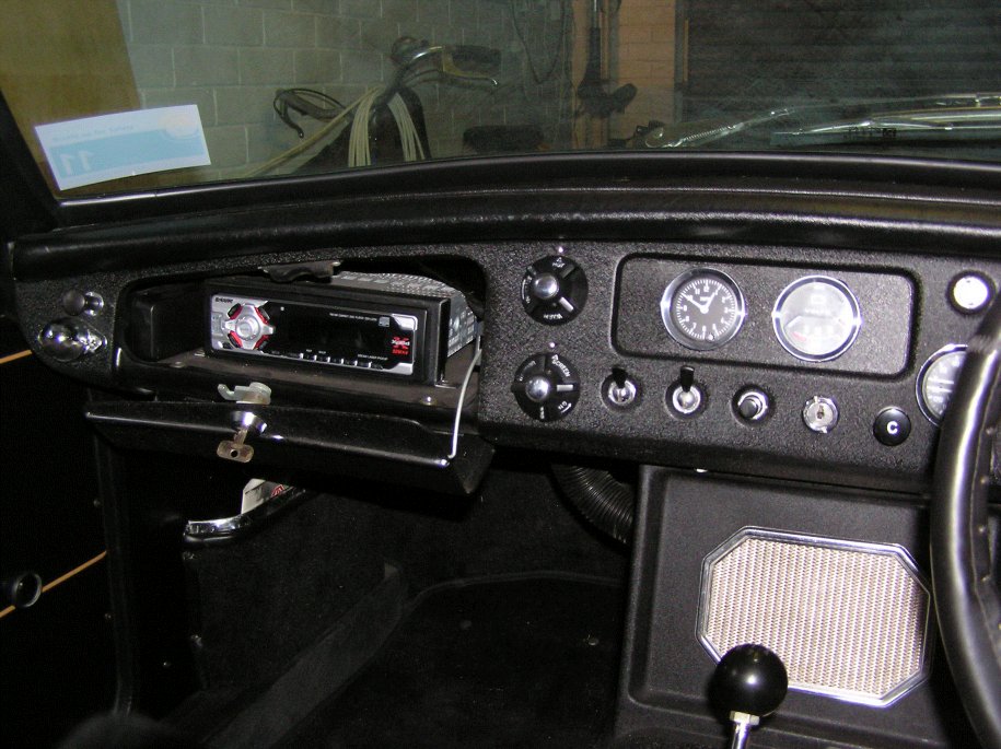

I reckon putting the stereo in the glovebox, particularly in a roadster is the way to. I have two MGs a CGT and a B Roadster and I've had the radios fitted the same way to both

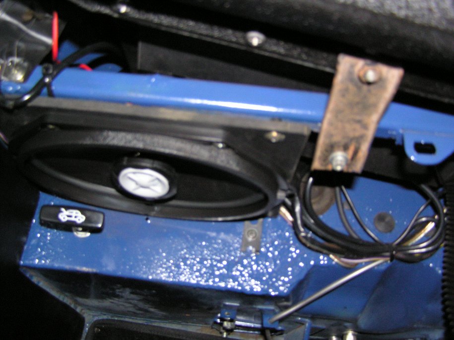

I've enclosed a couple of photos of the installation in the C GT, note the peice of fibreboard that is held in place by the crossmember under the dash at the back and by brackets to the firewall at the front.
Also note the speaker mounted underneath, there is another speaker behind the speaker grille,also there is enough room behind the glovebox to leave a shelf for the cd/radio's face case
The unit in this car is a Sony xplode unit which I wouldn't recommend for this sort of installation, the controls are far too fiddly. But it did have the option of what Sony call a rotary commander which is one of these stalk mounted remote controls (by wires)for the unit
My other car has a Pioneer unit which gives better sound, has a credit card remote and is far easier to use, having the more traditional two rotary control layout as opposed to a whole lot of buttons of the Sony.
At some point in the future I might look at putting in a remote IR sensor so that I don't need to open the govebox door to use the remote.
For the record the space where the radio would go is used in both cars for auxillary instruments, a Smiths clock and voltmeter.
Hope this helps
Tom
Sorry could only post 1 photo with initial reply, here is the other one
Tom
