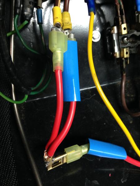

Not sure I follow you here. I still use bullets in most places (still using the original 1956 wiring harness too). But I'll continue to use up the Bosch-style relays, and of course use suitable quick connects to match them. I'm just not using the molded sockets.
Looking back, I'd have to say that the bullets (properly installed of course) are more reliable overall than the flat spade quick connects. I've had failures with both, but with the bullets it has always been (as best I can recall) the clip inside the sleeve that failed (or the ground clip screwed to the body). But several times now, I've had the quick connects get loose and either intermittently fail to make contact, or fall off entirely. Took me a long time to figure out why the Stag kept dropping out of overdrive; the ground wire to the solenoid was just loose enough that it sometimes wouldn't make contact while on the road. But of course it always worked perfectly while I was under the car trying to find the problem!

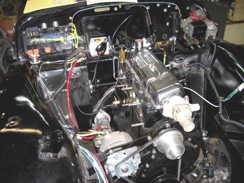

did you use 4 relays (2 per single headlight) or just 2 total?
4 relays, one for each filament. That way I could have a separate circuit breaker for each side (so still one headlight working if a circuit breaker blows or fails), but only run one new wire to each headlight. Kind of an experiment really, to see how I like the arrangement. My previous setup had a single fuse & relay for both low beam filaments (plus another for both high beam filaments) and I decided I didn't like that after a fuse failed while going down a mountain at night. There hadn't been any short, just some invisible corrosion on the fuse holder clips that finally generated enough heat on the long drive to melt the solder inside the fuse.
