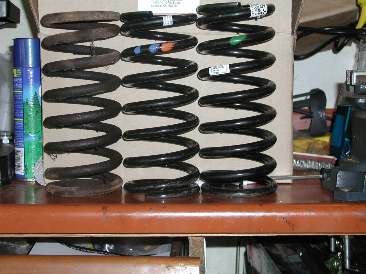

I went through this on my '68 Sprite. Springs MOSS Sent me at one point made Bugsy 1 look like an off roader. My Solution was a set of BE Springs. It took several iterations with MOSS and they realized they had some mismarked Springs. That was 15 years ago but looks like it's come back again.

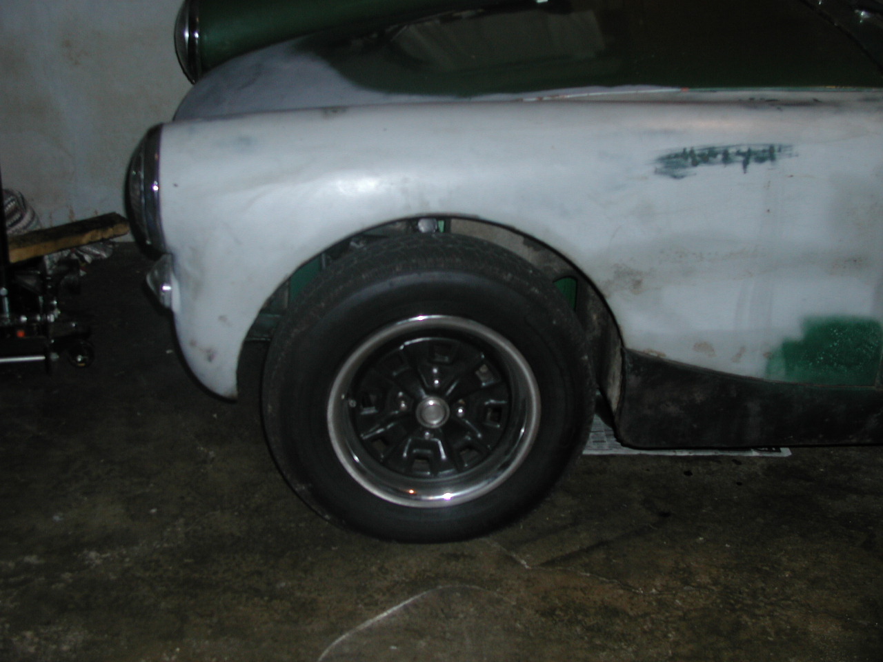

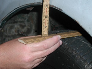

Not the first time I ran into this issue with Spring Heights. Springs do have a color code on them that means something to Moss or the Spring Mfg. Spring on the Left is stock from ,y '68 Sprite, spring on Right is what Moss Shipped, Spring in Center are the Coil Springs that also fit a BE. Center Pics show the effect of the Spring on the Right after install. It was definitely stiffer and taller. And BTW picture is dated 2/24/02. I've been part of this forum since 98 or 99. No wonder I know so many answers to these questions. Bet the color codes on the springs you received match the one's on the right.
