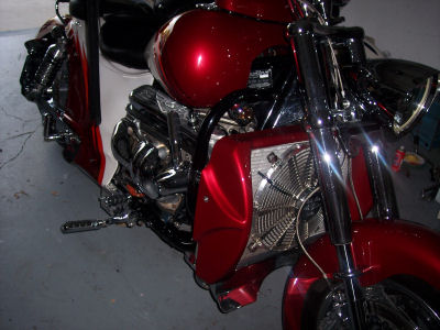

It is amazing how compactly a large engine can be made to be!! How about one of these,hehehe! /bcforum/images/%%GRAEMLIN_URL%%/jester.gif
(Chevy 350) /bcforum/images/%%GRAEMLIN_URL%%/shocked.gif
