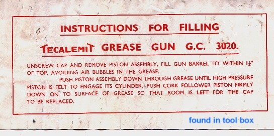

back to the Tool Kit: the original tool kit in my '65 S type has a black plastic screwdriver Handle that says "Jaguar" in the old style logo, and two metal screwdriver bits, one Phillips, one Blade. the plastic handle desintegrated into pieces. I tried gluing it back, but the plastic seems to have a "lubricant" in the composition that prevents any glue from drying or adhering. very weird. I tried super glue, epoxy, gorilla glue, and nothing works. I just "encapsulated" it in a vinyl cap to save it. All the tools say "Jaguar" on them, including the pliers. Attached is a picture of the "Stalagmite" Grease Gun (injector) LABEL that was wrapped around the tool itself.
