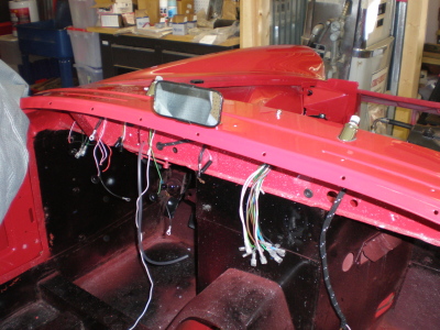

Bought my first tap and die set today (good Craftsman set, SAE sizes) and cleaned up the 1 remaining captive nut and the screw that I messed up while trying the nut in the first place. Very cool new tools, I can see all sorts of possible future uses.
Used a small magnet to hold a nut and washer in place for the other side, and got everything attached. Almost anti-climatic after all that effort removing the dash and gauges. Next up is to decide if I'm going to make a new dash right away, or just put the old one back on.

YAY!
healeyboz said:
Ahh, a mirror.
for me it's ahh, a mirror and a tap and die set ... T&D sets are almost a staple tool in this hobby ... and always buy a good set .. congrats drew
Tap and die set is very cool, did exactly what it was supposed to do. I probably won't be cutting new holes in things, but being able to clean up threads on nuts and bolts is very handy.

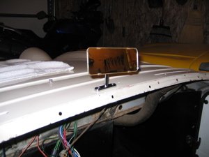

Where'd you guys get yours? mine is installed on my car &, sitting in the driver seat, I can adjust it properly.

Mine looks like it's mounted where yours is but the upper left corner just touches the shield when set right. It's usable but it vibrates a lot. Hopefully after extensive tinkering this winter, she'll run so smooth, the mirror issue will be gone...maybe.
Well it appears Tony has the correct mirror. After looking at as many pictures as I could it seems some of us have the wrong ones. I turned mine upside down but I don't know how effective it will be. The holes were slightly too far apart also. There are some for sale on ebay, I may indulge.

Drew, you have a generic replacement unit. I have one like it. I prefer it because it is larger. Mine is close to the windshield, but it does not touch.

That looks like the one I have too. PO probably put it on. It's usable but just barely, arm should angle away from the shield a tad and it'd be perfect.
Sure doesn't look much different from the black one but half the price, no wonder so many of us have them.
