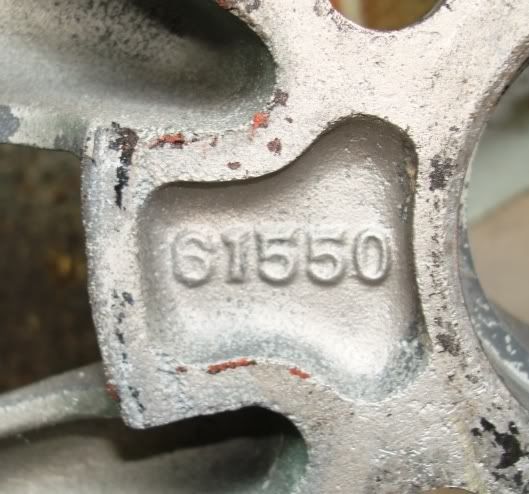

Hi group, I own a set of what I believe to be original minilights. They have been on my on-again off-again restoration of a 61 TR4 that has been in my family since the early 70's. Does anyone know how I can identify these has true minilights and how do I restore these for a new paint job. The only identifing mark I could find was on the inside of the wheel on one of the stud flanges with the numbwer 61550. There is an amount of white corrosion on them but not a large amount at all. Bottom line is what exactly do I have here and I do I restore them? They appear to be 15x6 but I may be measuring the width incorrecly.
Thanks for your input.
Scott

Is that not the number on the back of the American Racing Silverstones? I guess I could go in the garage and check if it was not early and dark outside. Got a picture? Bob
Well, actually you have American Racing Silverstones.

Thank you for the positive identification, it's nice to know exactly what I have here. What kind of shop would you reccommend for the evauluation of the wheels for future service? It appears a dye penetrant is adviseable.
Thanks, this site is great!
Scott
I'm not sure. Intuitively, I would think that dye penitrant may uncover something. The only other method that I am aware is x-ray examination with interpretation by a metalurigist who knows his stuff. However, this could be very expensive. perhaps a phone call to
American Racing
19067 South Reyes Avenue
Rancho Dominguez, CA 90221
310-761-4915
