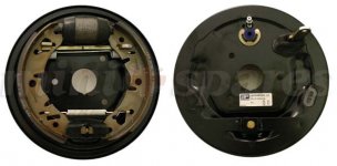

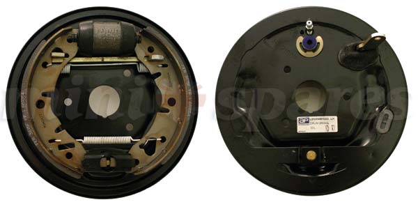

Shoes are "handed". Take a look at the picture linked below for a LEFT rear brake assembly. Note the friction liner is relieved at the top of the front shoe and bottom of the trailing shoe. The right side will be mirrored. If you don't have relieved shoes, grind away a bit of the material on the shoes you have (to heavily chamfer the edge that will contact the drum first). Failure to fit the shoes as shown can (but doesn't always) result in a spongy pedal with excessive travel. You can bleed forever and never get a firm pedal.

We've got shoes with NO chamfered lead ends. That's going to be "step one." I have high hopes for it.

Small improvement with the chamfering, it is taking "laps" and raising the rear for readjustment. There was a two-flat adjustment on the first run, no doubt the shoes "centered" themselves on that go. We progress apace. Each successive drive seems to give it some space to dial out. Pedal is improving as well. Front drums are also being checked/adjusted.

Had to "radius" all shoes at the leading ends. Now the brakes seem fine.
