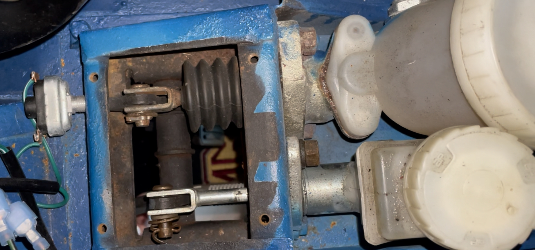

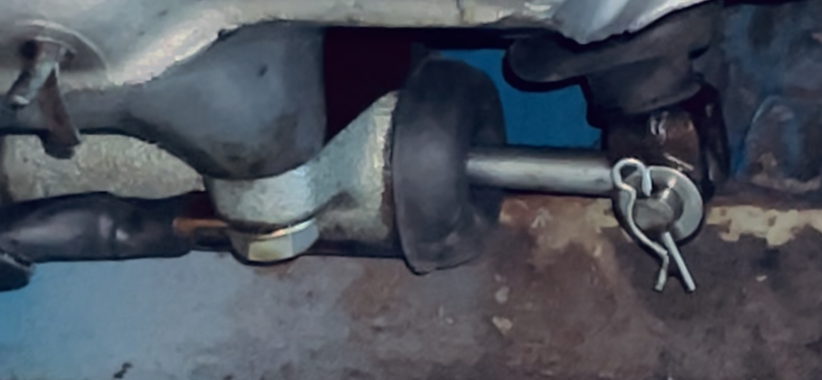

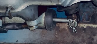

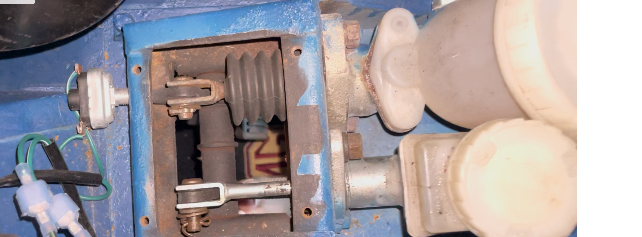

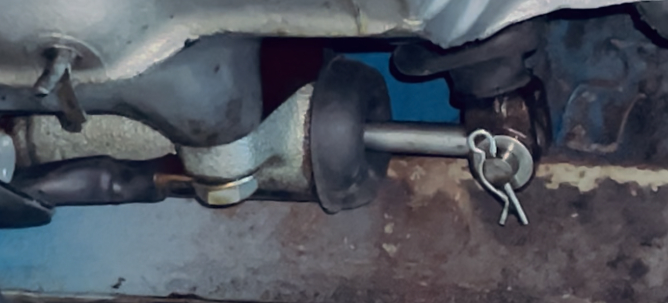

I have been trying to diagnose. What I have confirmed…
- idling about 800-900 rpm
- replaced pressure plate, disc, and bearing less than two months ago
- fluids look clean
- master and slave throw in attached pics…not sure what’s normal…master moves ~ 3/4”, slave only about a 1/4”. have to check my Haynes
any other thoughts?

JPSmit
1/4" throw seems short to me - a VERY common issue is the holes in the bracket (circled) wear and end up shaped like an oval. Also the clevis pin wears (If you see where the arrow is pointing it looks worn from here)

Thanks again. No oval wear identified. I did end up replacing the pin. I bled the master and the slave just to ensure there was nothing in the system. Same issue…i took a video of the squeal that occurs by the slave when the clutch is depressed…any way to post a vid here?
Jim_Gruber
You can also have wear at the pivot point but that is less likely. Have seen Pedal Arm ovaled out as well.
