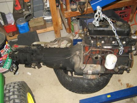

I am pulling and engine and trans from my MGB and want to know what attachment points are commonly used on the engine.
I was thinking about using a 2 of the intake stud holes and then the the alternator bracket.
By the way.. Does $100 sound fair for a running engine? Any buyers out there in Michigan?

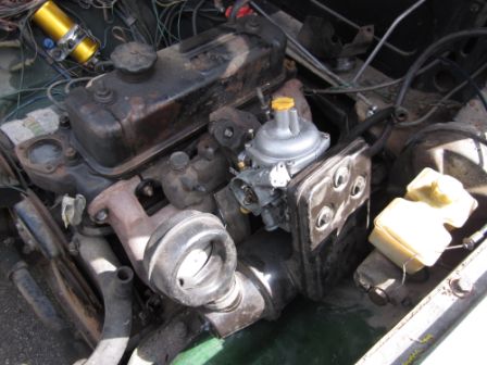

I just completed a clutch rebuild, and used the front alternator bracket and the back exhaust manifold stud:
(Click for bigger.)

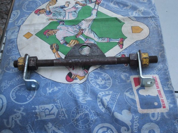

This may seem like a lot of fussing but this is a home-made tool for the job, patterned after the factory one and will work on <span style="font-style: italic">any</span> BMC engine:

Thanks..
Engine and trans out.. Can't wait to install the OD in my good car. Seems a shame that this MGB may never see another engine again.
