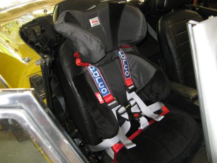

This is a custom seat kid I am installing in my MGB.

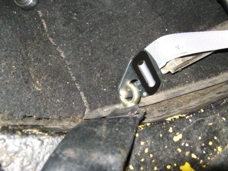

Base seat is a Britax Parkway (30-100lbs)with assorted hardware from a Britax Regent. We have Britax seats in our regular vehicles so the harness will not feel different to our kids.

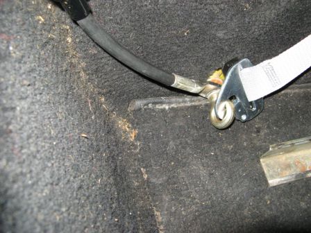

I added one additional ratchet strap around the bottom of the seat to hold the center buckle.
All original seat belt anchor points were used.
I used the top half of a SPARCO 3 point harness that I bought on Ebay and some race seat latch and hook hardware from JEGS.
The orginal seat belts are still in place and can be used in addition to these.
