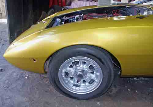

After I posted that it struck me that I had been playing around with wheels on my Jamaican MGA last night. It has wires and I wanted wider wires from Dayton and needed to check possible width and offset.
I remembered that the magnesium Campagnolos on my old Lambo were the same spline, so I pulled out the spare (brand new tire and rim, never been on a car), and tried it on the MGA.
It would fit, but I decided that 6" was a better width than the 7" of the Lambo so I am having some Cobra 15 x 6 centrelaced wheels made up for it.
I think that an MGA with the Campagnolos would look pretty interesting.......
