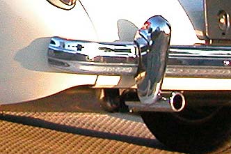

Here's my sound system. /bcforum/images/%%GRAEMLIN_URL%%/wink.gif
