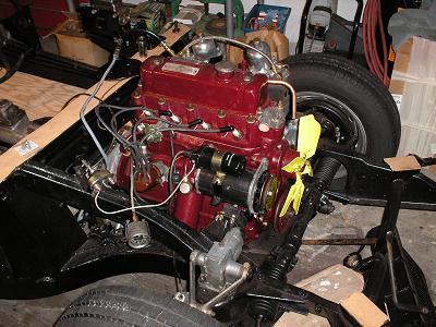

Thanks Gents for the advice. Unfortunately the early A's have a solid block of cast steel that has both the brake and clutch master cylinders bored into it. Moss has a "new" replacement for $400+ and I figgered that $400 would be worth a careful honing. You're undoubtedly right about the bore being too large. I'll need to get an inside mike and check the diameter! One never knows the history of a garage find, eh?? Didn't think about the local machine shop. The folks at Rod's Automotive did a bang up job on the block and head(and cheap!). The body is off the chassis, so it won't be any problem to pull the master cylinder. It's been a blast driving the chassis around the neighborhood, sort of like a giant go-kart!! As far as sleeving the cylinder, I'll google Apple Hydraulics and see what's up...Thanks again!

Hey Jlaird! Thanks very much for the links. I like the prices at Apple Hydraulics! They're less than 1/2 price for a remanufactured master cylinder.
Good luck on the bugeye project...I'm beginning to think that all our garages sort of look the same...
