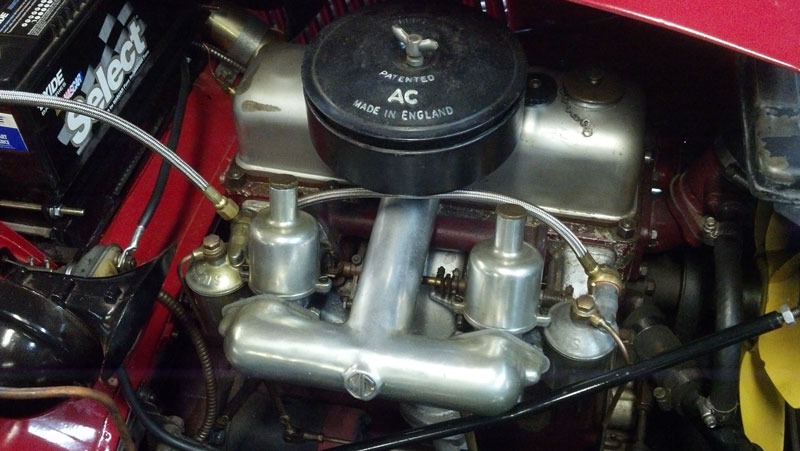

So, that's not the correct air filter? Got a pic of the originals?

The original TD air filter was an oil bath filter.
An upgraded, original looking, replacement can be obtained here:
https://www.mgbits.com/contents/en-uk/p8541_Filter-Reproduction-Air-Cleaner.html
If you do not have the intake manifold they also have them.

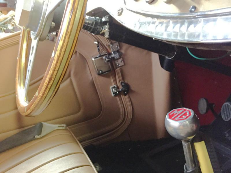

You can add additional safety locks to the doors if they are of concern. These are period correct and available from FTFU (From the frame up).
Also there is a lot of adjustment in the door locks themselves, BUT if they look worn, the holes in the door pillars are oval or enlarged, do your self a favor and get new ones.
I replaced the wooden door pillars on my tub and tried installing the old/broken/worn latches for months. I finally broke down and got new ones (Abingdon Spares) and finally, still with much work , got them to lock well.
I have not used the safety lashes much.
