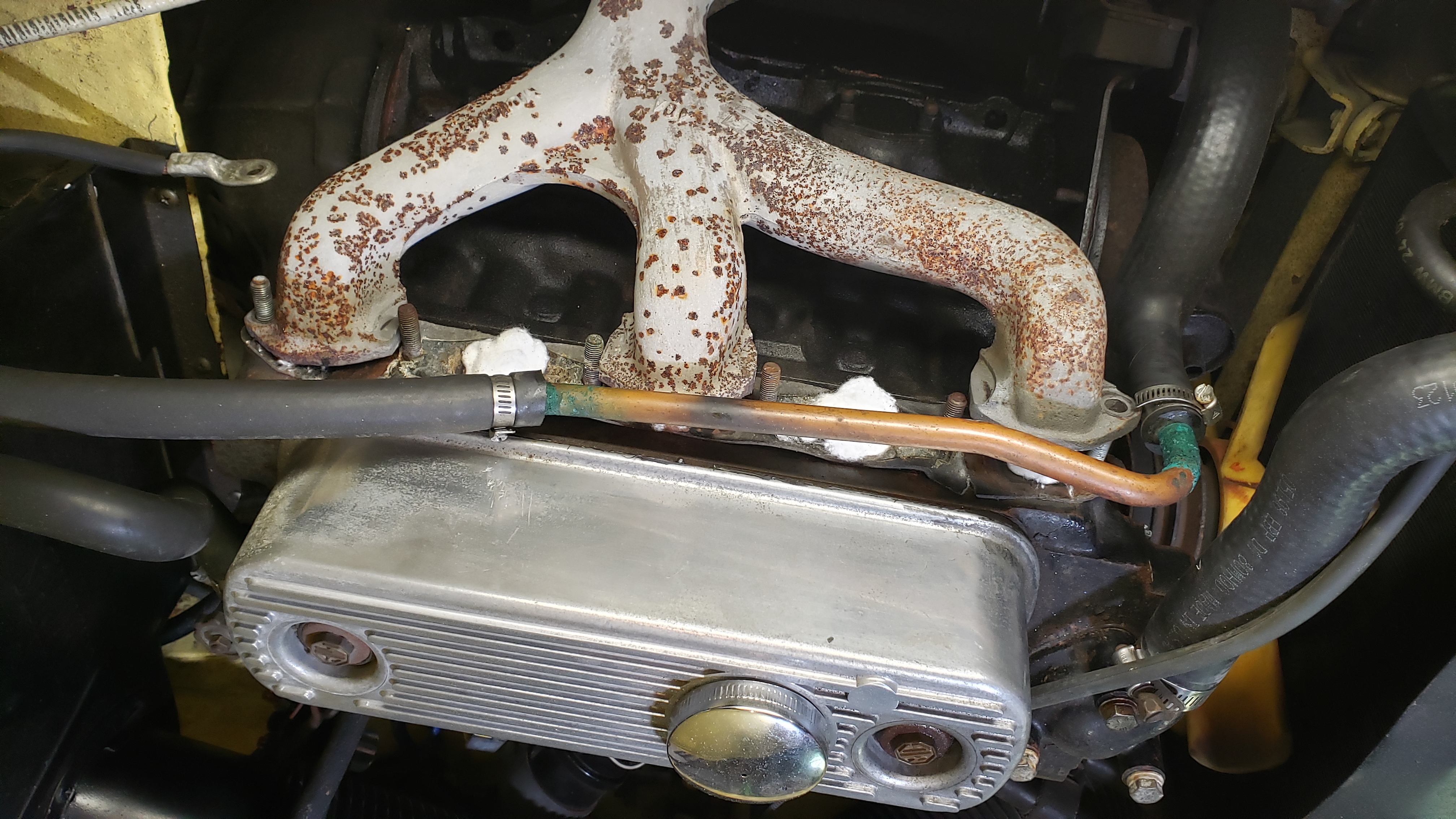

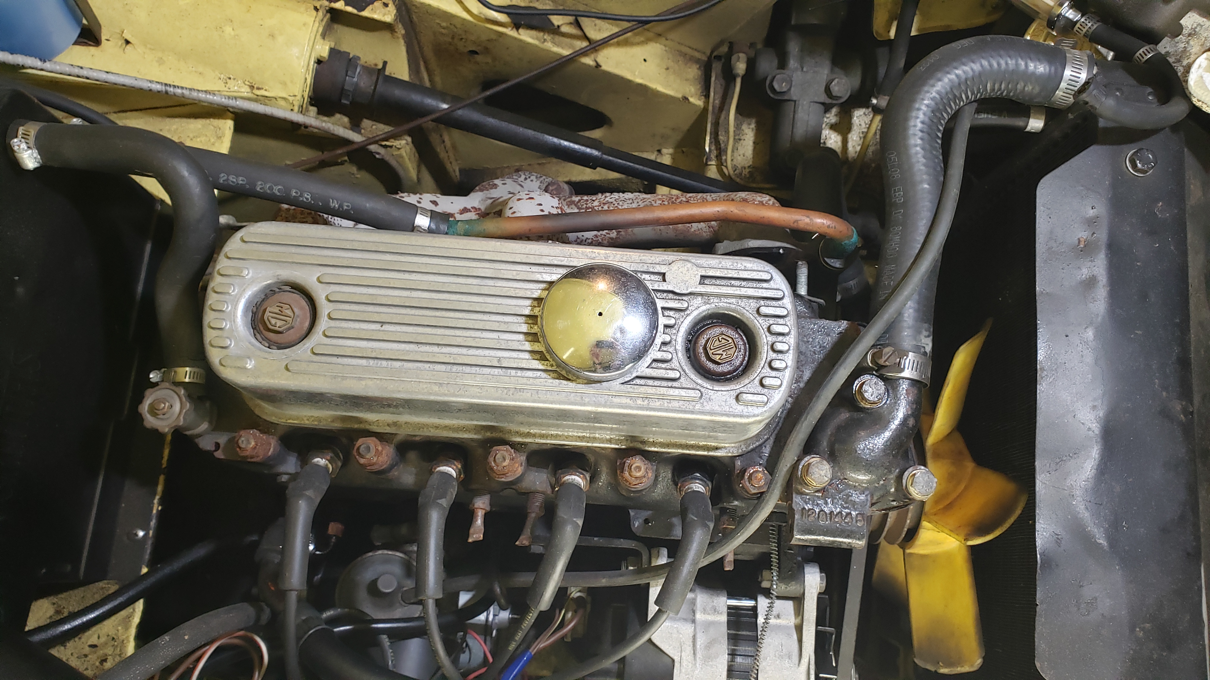

Hi, I am helping a friend with her 74 MG Midget that supposedly has a 75 Midget engine. It needs an exhaust/intake gasket. Although what I find online doesn't look anything like the ports on the head. There is no ID plate on the block. Any other way to determine what it is? I have pics if that will help and found the code 11B on the left side of the block.
Thanks for any help!
Post a picture and we should be able to help ID the engine

WAG: Austin/Morris/MG 1100cc. ??
Pretty sure that's a 1275 A-series engine, appropriate for a '74 Midget. The presence of the air injection ports on the heads is a pretty good indicator.
Not sure where you are, but Moss Motors or British Parts Northwest should have the manifold gasket:
> Manifolds & Heatshields - 1275 - Exhaust - MG Midget, Austin Healey Sprite | Moss Motors <
Moss part number is 296-630, used on all Sprites/Midgets that used the A-series engine.
