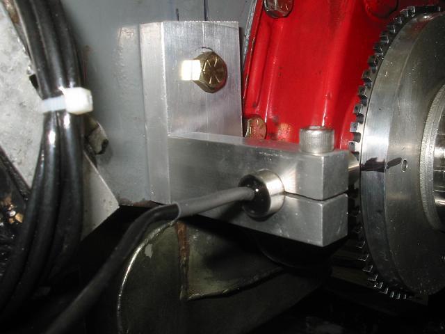

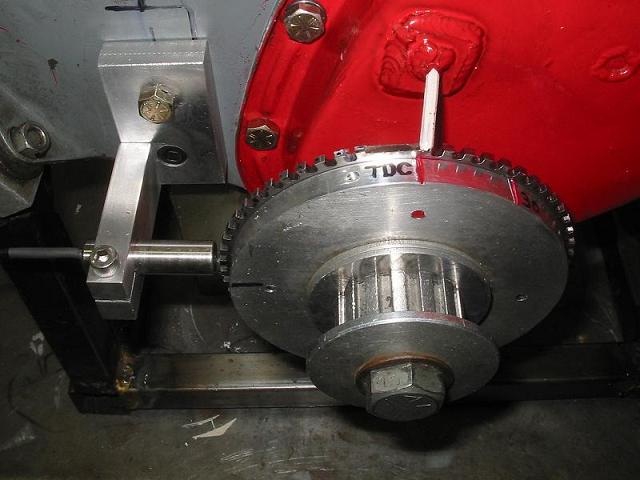

The Westfield kit this is going into has lots of room in front of the crank damper.
My understanding of the trigger/sensor relationship is that as long as the missing tooth is 90 ahead of TDC the sensor can be located anywhere. As long as the computer can count 9 teeth after the missing tooth passes by and use that as TDC for it's calculations the sensor can be mounted on the right side of the engine, or the left or bottom or anywhere in between. It can also be mounted facing into the crank or along the crank axis, wherever it can get a good look at the teeth(1mm +- .5mm clearance). I am going down to my friends salvage yard tomorrow to poke around for the parts: he has over 2000 cars in the lot and hundreds of engines in the warehouse. Any Ford trigger V-8, V-6, or 4 will do, same with the VR sensor. The Ford box has to be a 4-cyl. type same as the coil. I was thinking of mounting the coil pack on a bracket where the old dist used to be and use the dist hole as another breather.
I should have the kit early next week and will report on the assembly then. Installation will have to wait until after the new year.
