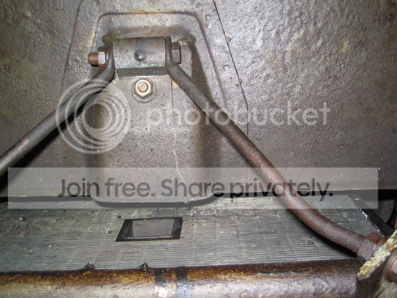

On a 3A, the guide mounts to the floor of the grill opening with a single bolt. Then there are two reinforcing rods (similar but not identical to the rods for the radiator) that go from it down to the tabs on the frame.

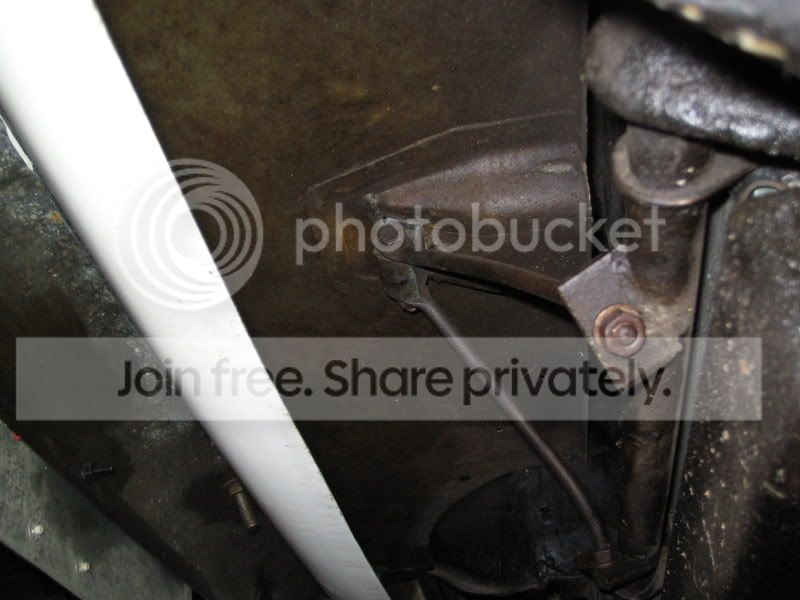

I hope these pictures help. As they say, a picture tells a thousand words.

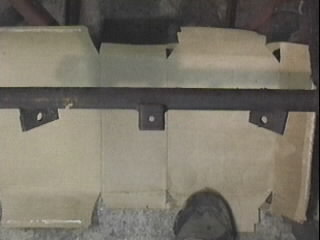

This is all I could find. These are the ears where the threaded ends of the support rods attach. The photos above really show it all. You have to fasten it all in place rather loosely, then insert the crank making sure the teeth are engaged in the end of the bolt on the front of the crankshaft and pulley, then tighten all the nuts securely. Remove the crank and try to re-insert it and verify that it engages the crank bolt as before.
