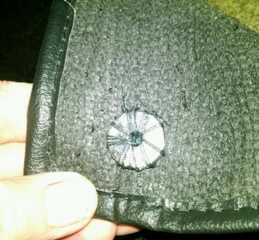

I'm using the washer-style countersunk super magnets to hold my carpets in place up under the dash. They're much too strong to come loose and float around in the pan. You could attach 2 or 3 in a stack on the end of the drain plug as long as there's clearance from any moving parts.

That's a great application--I have a couple of spots on the armacord that want to pull away from the sheet metal.
I'm getting more magnets!
