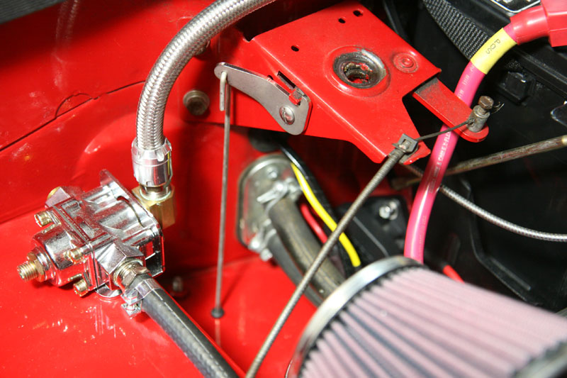

Here it is installed:

justin_mercier said:
You may want to get yourself a stop-nut so that you can pull down the release, but not so far that the arm moves past the release point and lets it re-latch.
Hi Justin,
It came with one, but it has to go so far past the amount it take to open, that I just don't see that happening. But I'll think about installing it.
-Darrell

OK, so I'm a little slow sometimes. Figured out why a stop on the lever is a good idea. Not just from using the back up release, but even pulling the normal release too far will let the lever turn past the little arm on the release.
That's why you want the top of the lever to just touch to bottom of the little arm of the release, yours looks a touch low...
Yes, I had to mount it a bit low due to another hole that was there previously (from a hood lock).
