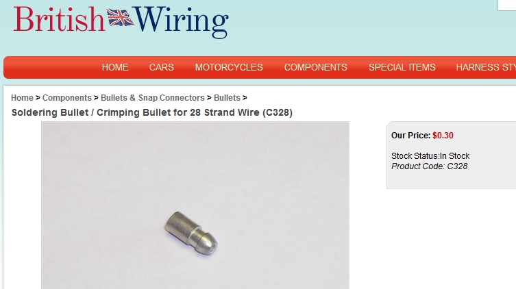

If British Wiring doesn't have them, I think you're outta luck. Why not use the crimp type (I think that's what was originally used)?
I have found them on flea bay in the UK and also Triple C in the US has them but they are closed until March as they are moving . Looks like an across the pond order is going to be my best bet .

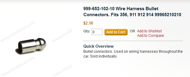

IMO, you are better off crimping the bullet terminals. The terminal in the images above is made for crimping; that's part of what the narrowed 'neck' at the tip is for (it may also strengthen the connection). If you crimp, you only have to remove about 1/8" of insulation; and the 'sleeve' of the terminal covers insulated wire. If you solder you will need to remove the length of the bullet terminal, and may well burn the insulation above the terminal (you have to get the terminal pretty hot to fill it with solder). It's also quicker to crimp, though if you're only doing a couple that may not matter.
