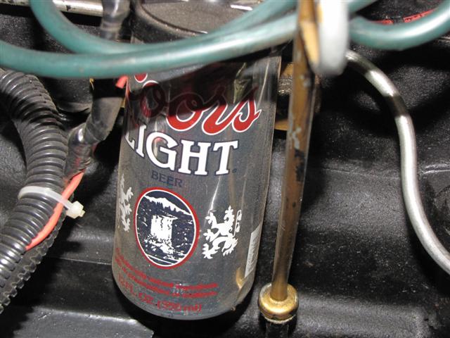

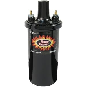

Something like these,Steve ?
It may have had a sticker, but it is the same size as a properly "engraved" DLB 105 that I recently gave away.
