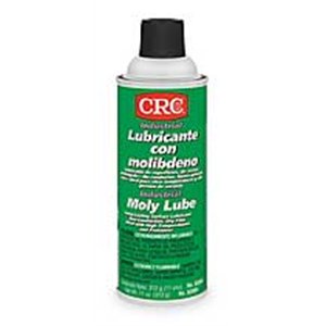

70herald said:
The Al socket was worn enough that the ball pushed right through the bottom...
That portion looks reasonably similar to the TR box, where I find that dry spray "moly" lube works well.
