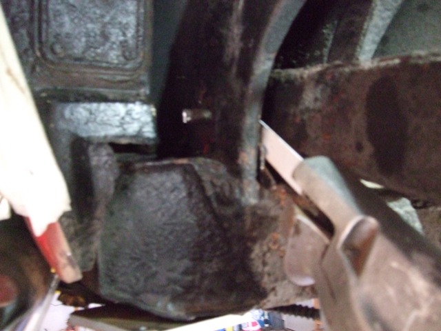

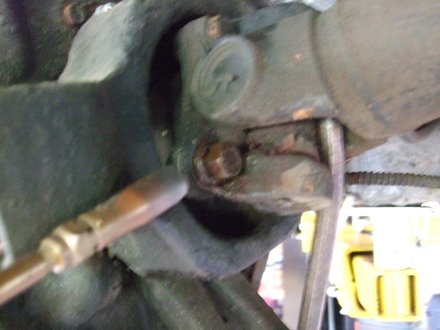

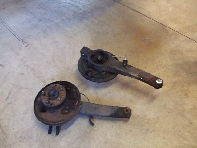

Hi Jeepster, you can saw the bolts off and that will work or you can also use heat. A standard home hobbiest propane torch will provide enough heat to loosen things up. I have not needed to do this on a Healey but I have done it many times on Corvettes. Here are some pics of cutting the bolts out of the pivot on the rear trailing arms of an early corvette. I almost always have to cut the bolts with a SawZaw blade on the Vettes because the bolts are shrouded by the body and impossible to drive out with a hammer. In the one pic you will see the white blade cutting the bolt hidden inside the rear dog leg of the rear frame rail. (use a long blade). Another pic shows the trailing arms on the floor after I cut the pivot bolts. The one trailing arm still shows the cut bolt stuck in the pivot. Cheers.
