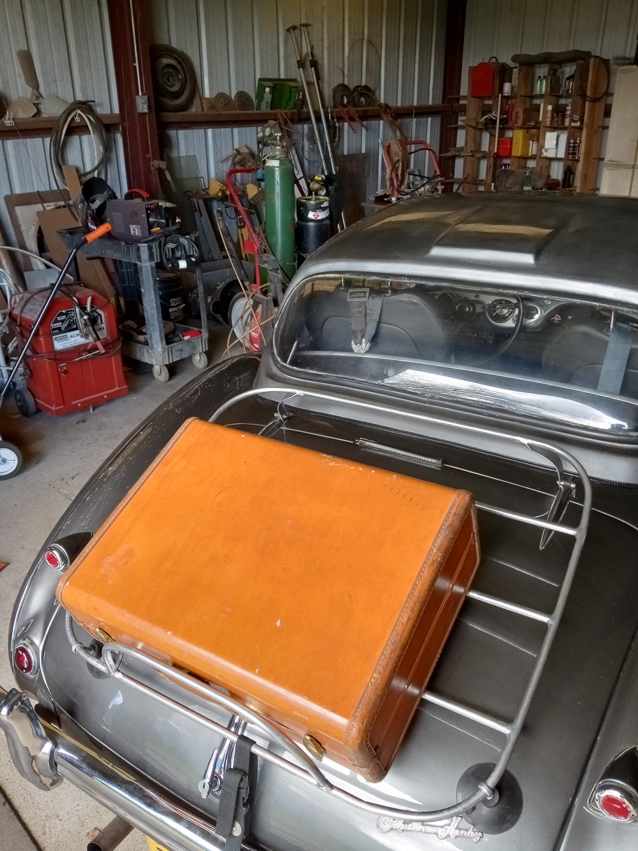

Just an update. This past Sunday was the Capay Valley Almond Festival. One of our stops on the
way to Rumsey for some food was at an antique shop owned by a friend in Gunda. On a shelf was a 195Os vintage Samsonite leather covered suitcase that was a perfect fit for my luggage rack. A couple of leather straps and I'll be set.
My parents had a set of those when I was a kid. They were very heavy compared to modern luggage, but very durable.
