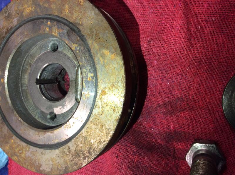

Well I found the problem.
it is the main crank pulley. I had replaced it with a Moss vibration dampener type two years ago.
Completely wallowed out & wobbles on the shaft.. I hope my drive shaft is made of tougher stuff.
