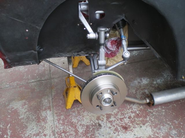

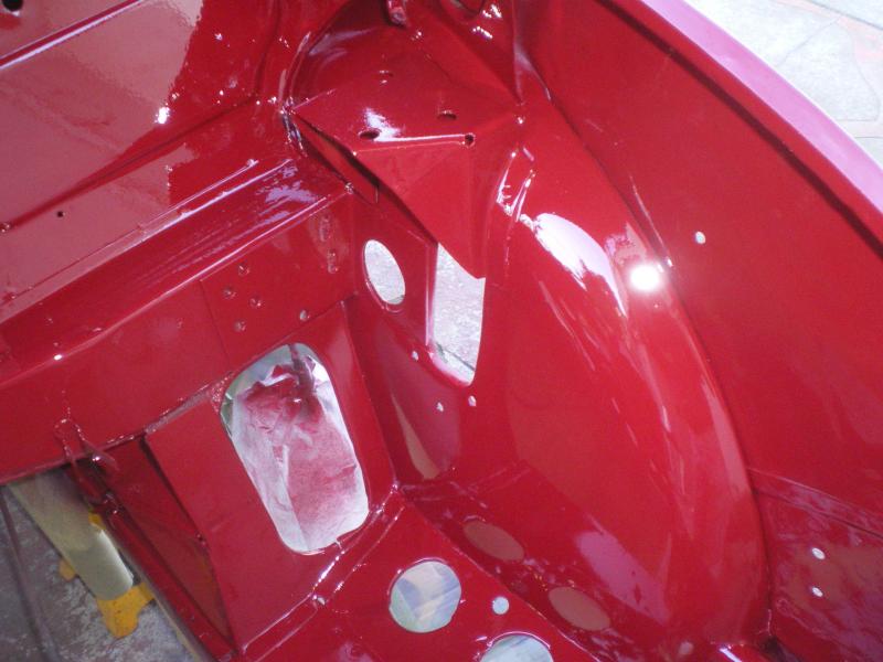

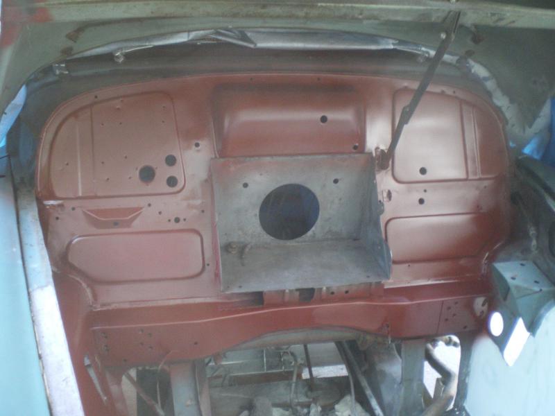

Here's a Traveller I have been restoring. In this picture, you can see the rack just under the horizontal beam. The rack is same used on early Sprites and Midgets. The horizontal beam is structural and you can see where the shocks would mount to the left and right ends.To give you an idea of the relationship between the rack and gearbox, if you've ever noticed the rubber bung that fits in the oval hole at the back of the bell housing, in a Morris, the rack sits right behind and about that location, by about 3/4"- 1/2". There steering arms come off the back of the king pins, instead of in front. There steering arms come off the back of the king pins, instead of in front.
