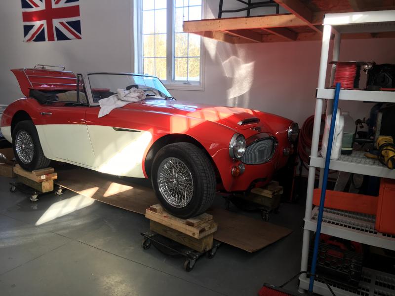

Looking pretty
I love the color combination.............especially with the new wheels. I will be looking for new tires this year; what size and brand did you decide on........ yours appear to to be a great fit for your car and will look perfect when the rear suspension settles.
John
John
The wheels are from Dayton Whire Wheels . 15X5.5" 72 stainless spoke with BF Goodrich Traction TA 195X65 15s .
I run them on my BRG 67BJ8 as well very happy .
Why is the body sitting so high?
Smile for the camera .
Seriously considering the bumperless look . Looks so uncluttered .

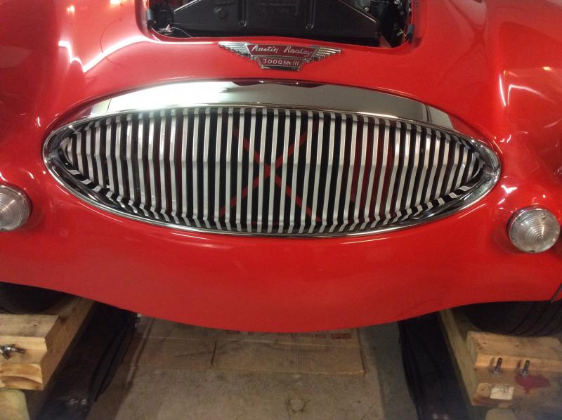

Well its getting down to the fine details now . Progress has been slow due to a new home build that Im doing but part of that is a new 32X40 workshop with 13ft ceilings so lots of room for the hoist and toys and room to work .
Looking good but now you'll have to give us update photos of the shop to!

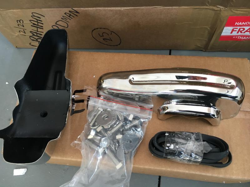

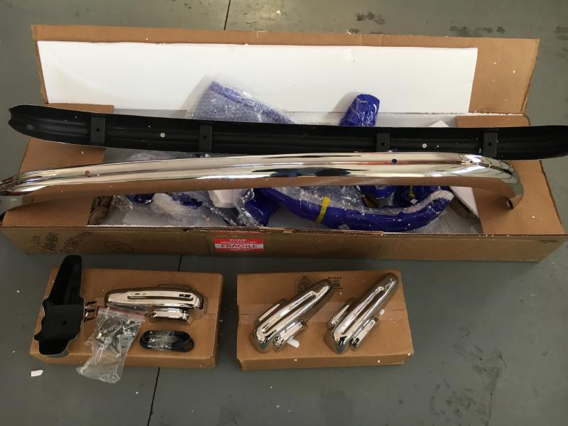

Well, 2017 is almost done so time for an update on the 64. Not a lot has happened as I was building the house, but that's mostly done now so once I finish working on the Vantage and her Z4 to tuck them away for the winter nap I can get back on the 64 and finish it .
But first the disclaimer ... if you are a concours purist, look away, do not read this post as it may cause heart palpitations shortness of breath and possible anaphylaxis.:welcoming:.
I decided after a very long debate to go with repro stainless bumpers as I only had one good OEM candidate for rechrome and seeing as I am absolutely not a concours guy and never will be I went stainless.
I picked them up today from my local UPS store and they are stunning. You can't tell they are stainless unless you use a magnet on them, the finish is so highly polished. They came off flea bay and the cost was about the same as if I had the originals redone.
