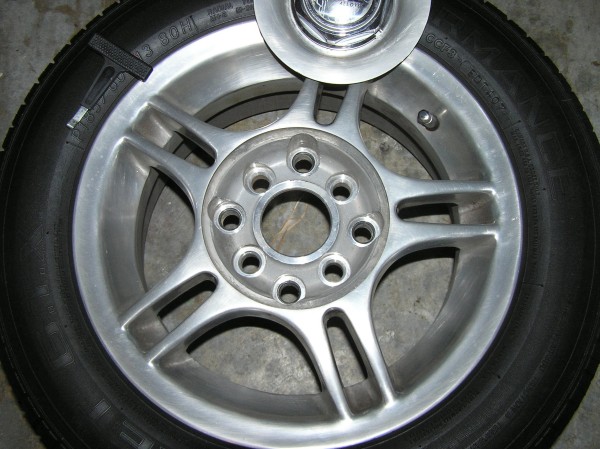

Any idea about these, supposed to be a 13 inch American Racing Mag Wheel:
