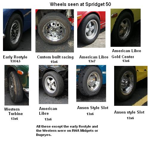

For a square arch Spridget the selection is pretty limited because of tire clearance. Other than vintage wheels, the only non minilite style wheels I know of are either the Revolution or a new design recently released by Performance Superlite that resembles the MGB LE style wheel but in 13". Check with Hap at Acme Speed Shop for information on these. Most of the vitage wheels designed for the Chevy Monza/Vega body styles are a bit on the wide side (6" usually) and have a bit too much offset for a SWA. Fit a RWA pretty well though. Here are some shots of some of the options available seen at Spridget 50. If you want more information on the racing wheel I'll have to contact Prather Racing and get the details as they ordered these for the owner.

Thanks guys, I really like the look of those Libre wheels.
I'd have to see the Challenger on a car to really get the feel for it.

A lot of Spridget racers used the Libre's and slots over the years. Many have upgraded to newer style wheels so check with the local SCCA or vintage racers in your area for their classifieds. You may have some luck at hot rod type swap meets as well, I found a couple of pairs of slots at those over the years that now mount my slicks for autocrossing. They are getting harder to find though as most of the wheels have been out of production since the late 70s.
