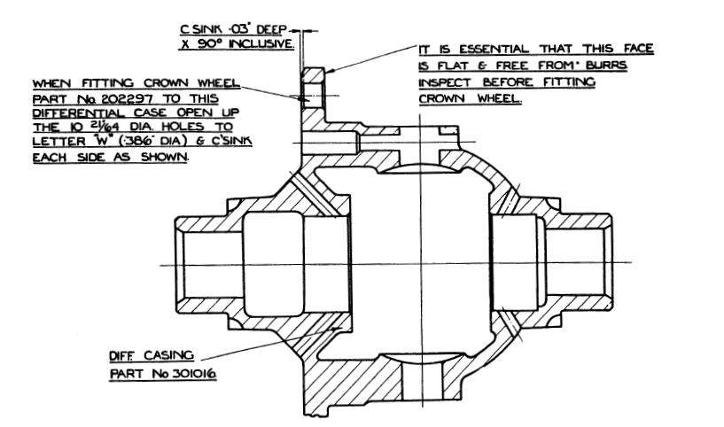

Yes, except that I'm not certain what is involved in installing a late TR6 gear set (designed for the collapsible spacer) into an earlier differential (designed for a fixed spacer). The part number changed, so there must be some difference in the gear set. But possibly all you have to do is use the collapsible spacer.
PS, never mind. The late TR6 housing stayed the same part number, so all you have to do is use the collapsible spacer to fit a late gear set.
The gear set will even fit into the TR2-early TR3 "Mayflower" axle. For very early TR2s, it may be necessary to ream out the holes in the carrier (a factory-approved modification).
