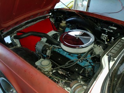

MORE??? With all due repect, I would have to disagree.
A 5.7L can provide alot more power with little or no effort. /ubbthreads/images/graemlins/cool.gif
Now, if you have access to all the BMW parts in the free world it might be easier to convert.
Using a small block V8 can provide virtually endless configurations.

I believe the Ford 302 is probably the most common swap. The weight of the Ford V8 and Triumph six are very close.
A 4 banger (even turbo'd) in a TR6 seems like a backward step somehow but if you do go ahead with it you can use a Hyundai Stellar 2.0L 5spd gearbox to help convert to rwd.
If you want to take this offline, I'd be glad to....
Many lessons learned and TO BE learned.
Jeff
