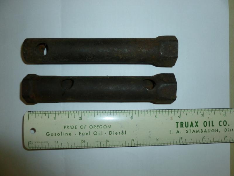

Anybody know what model these factory tools came from? The top tool has a 3/4" socket on 1 end and 1 Tommy bar hole.
The lower tool has a 3/4" socket on 1 end and a 13/16" spark plug wrench on the other with 2 Tommy bar holes.
I responded to Vila's ad and evidently they aren't from a TR4 tool kit. They need a new home.

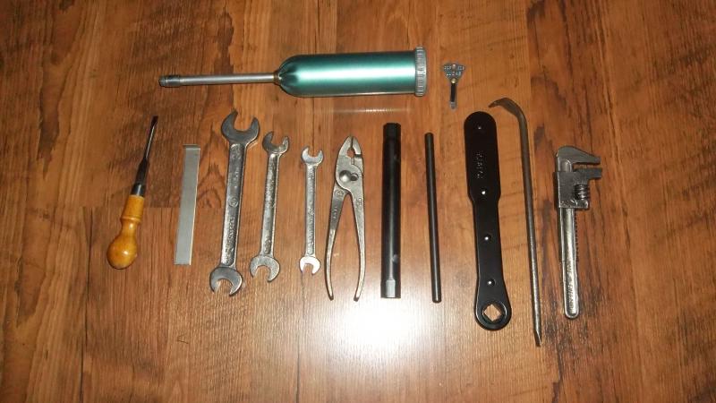

Ghawk16, here are the tools listed in the "Triumph 20 TR4 Spare Parts Catalogue". I believe I listed all tools from the catalogue.
1. Wheel nut spanner (Folding wrench used with steel wheels only. You can see it to the right in Geo,s kit).
2. Headlight rim removal tool
3. 3/8 x 7/16 AF spanner (TW Slimline open end wrench)
4. 5/8 x 3/4 AF spanner (TW Slimline open end wrench)
5. 1/2 x 9/16 AF spanner (TW Slimline open end wrench)
6. Slip joint Grips (English pliers)
7. Screwdriver (Usually Sheffield or Marples brand, approximately 6 or 7 inches long with 1/4 inch-ish blade.
8. Tommy Bar (for tube and spark plug spanners)
9. 1/2 x .56 Tube Spanner (I have)
10. Spark Plug Spanner (I don't have. It looks similar to Titanic's top spanner pictured above except it is 13/16)
11. Tecalemite grease gun
12. Adjustable wrench
13. Feeler gauge (I don't have. I don't believe every kit had this, but as I recall it is 3 pieces of gauge metal riveted in the middle for a total of 6 gauges)
14. Distributor screwdriver / gauge (This is that little Lucas tool with a feeler riveted to it)
15. Vertical screw style jack. (I also keep a scissors jack wrapped in a towel in trunk)
16. Jack Ratchet handle
17. Tool roll
I also have the tool for removing the hubcaps, but it is not listed in the catalogue (approximately 3/8 x 10 inches long with hook on one end as pictured
My kit is for a steel wheel car, if you have wire wheels you can eliminate the Wheel Nut spanner and add the knock off hammer (called a "Mallet, hub nut" in the parts catalogue).

Berry, the bottom one might be for an air cooled VW engine.
titanic
Hi PB-Actually the bottom tool looks like the spark plug wrench from a TR6 tool kit shown in the vol. 2 TRF catalog, plate GT #19.

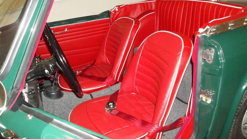

I used a picture of my TR4 interior to work through the steps. :cool:
