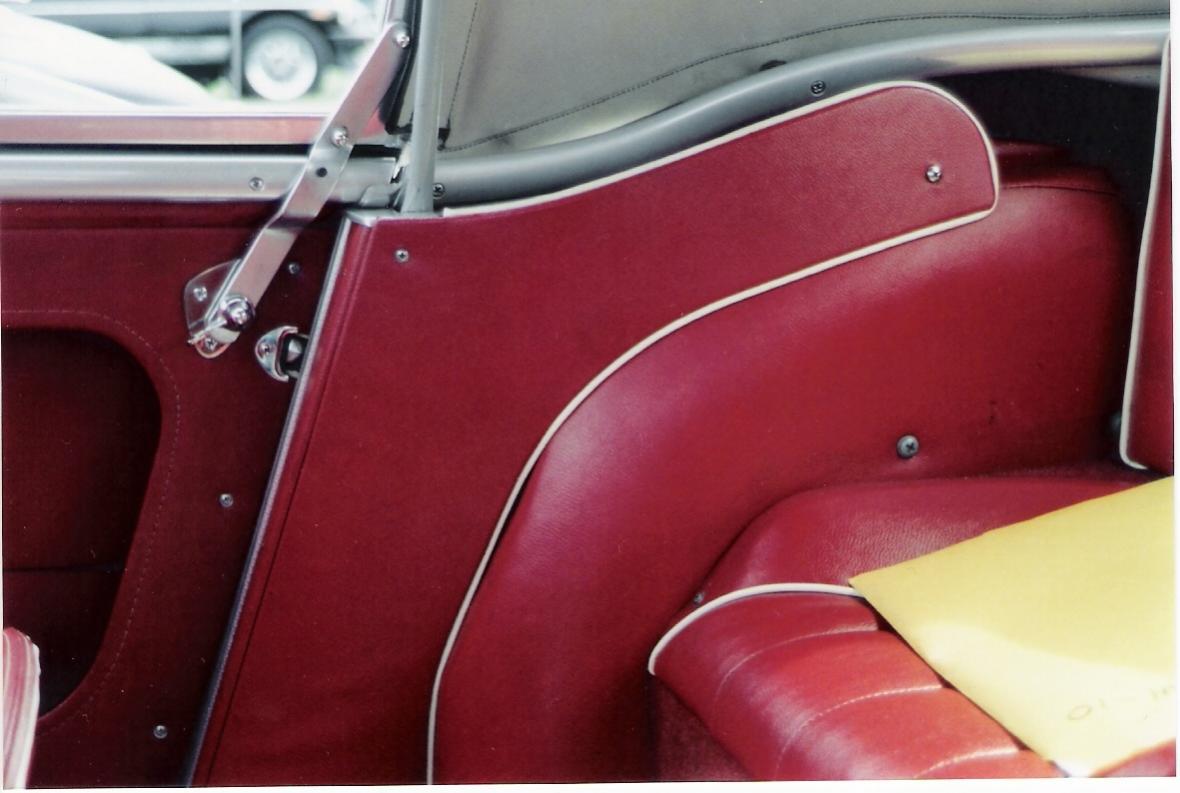

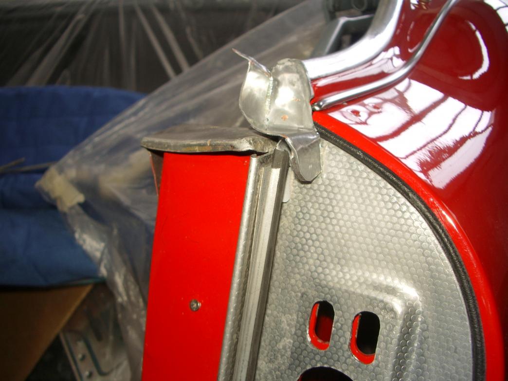

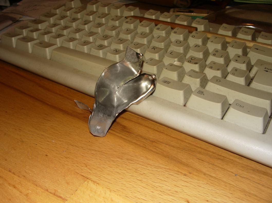

Interesting and easy to do MOD MOD TOP1.jpgit also finish well the ends of cockpit trim on longbridge100_1338.jpg

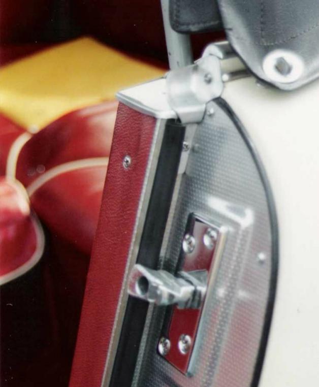

anyone applied it? I am care about the door aluminiumMOD TOP2.jpg trim conflict

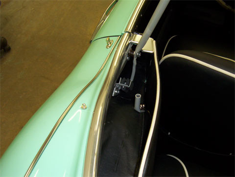

Andrea - I have not tried it, But I do have a question of your first photo. What information do you have about it? It appears to be an Ivory exterior with a red interior with cream piping. According to the Concours Guide for 2012, this piping on the door shut pillar should be cream and not black as shown in the photo. Do you have any informatioon you can share about this question.
as always, thanks for the great photos for those of us with the Longbridge BN4

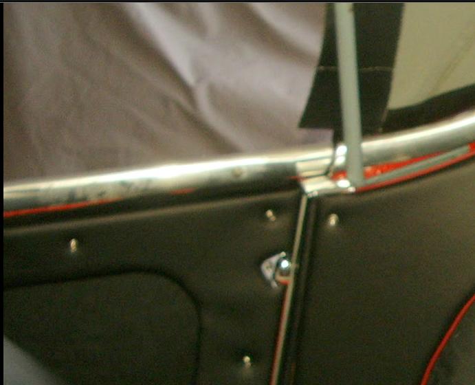

scan0003.jpgHi Jim
this is the only other photo of the MOD that I have find

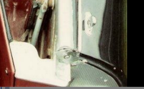

from 100 Six Derek site https://www.healeysix.net/Longbridge2.htm photos are from Rich Chrisler, and here I have find a 3rd car with this modMOD top3redinterior.jpg
NOTE on my previos thread car are TWO, one white and one black- on the third photo the car are black with black pipe(the light on the photo mix up)
the presence of the MOD on a 3rd car reveal tha this mod was extensively used on 100 six Longbridge cars
Cheers

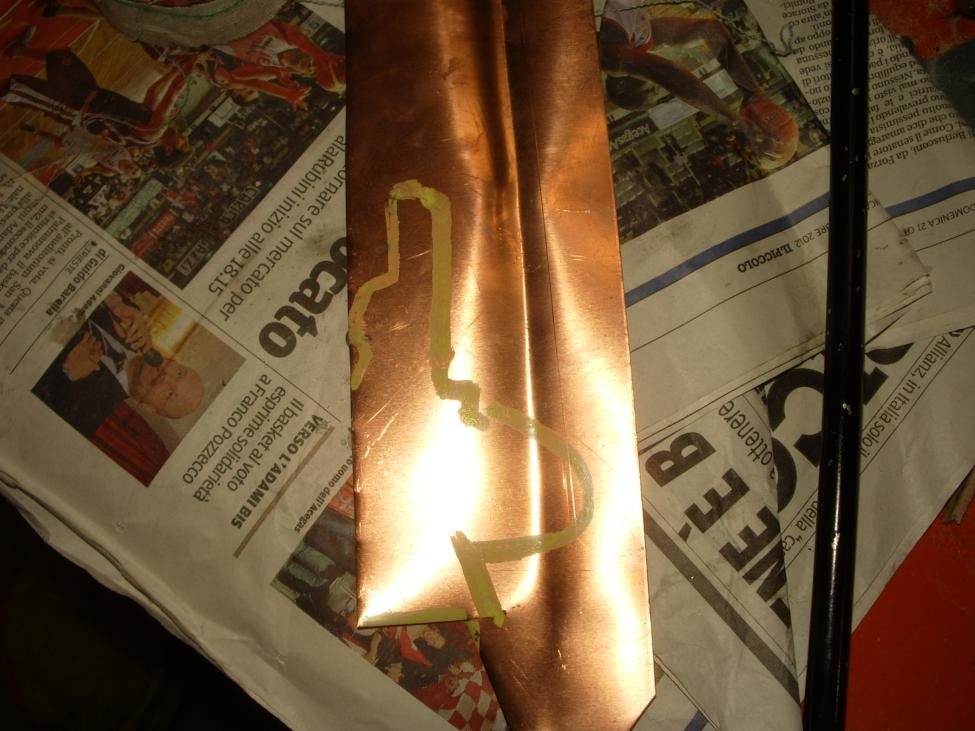

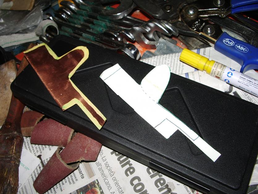

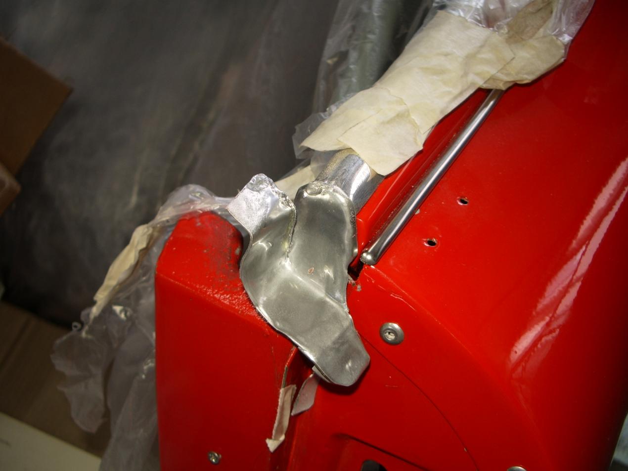

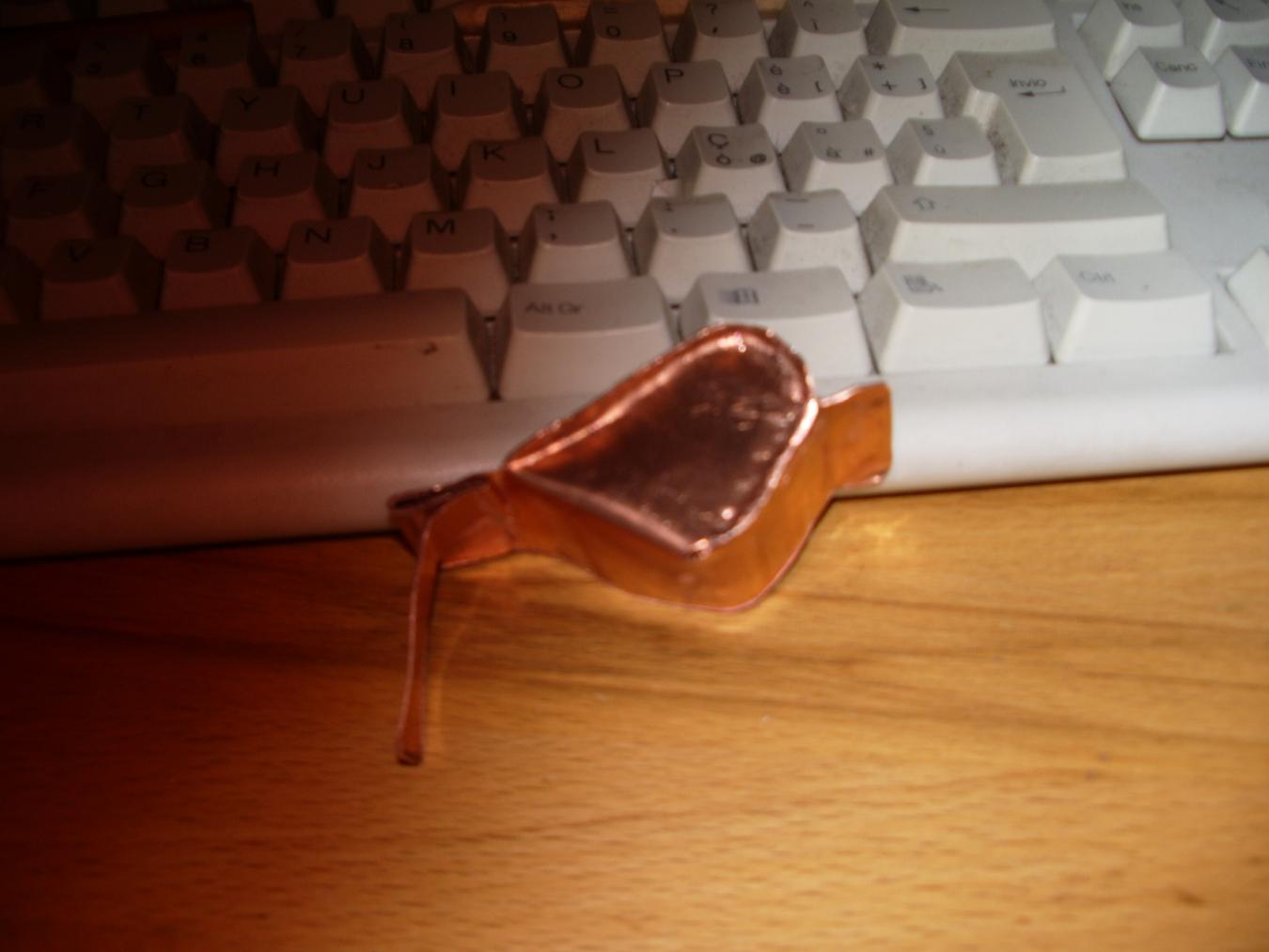

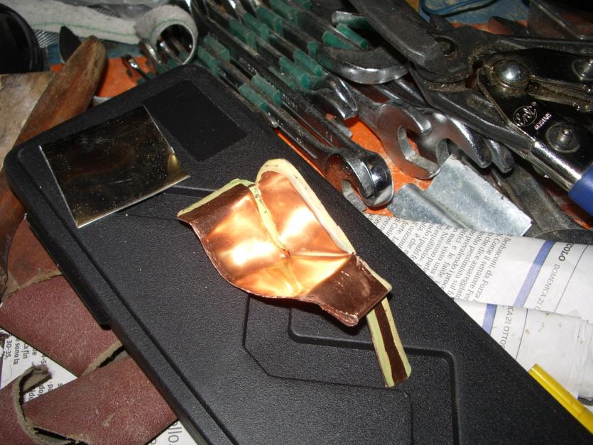

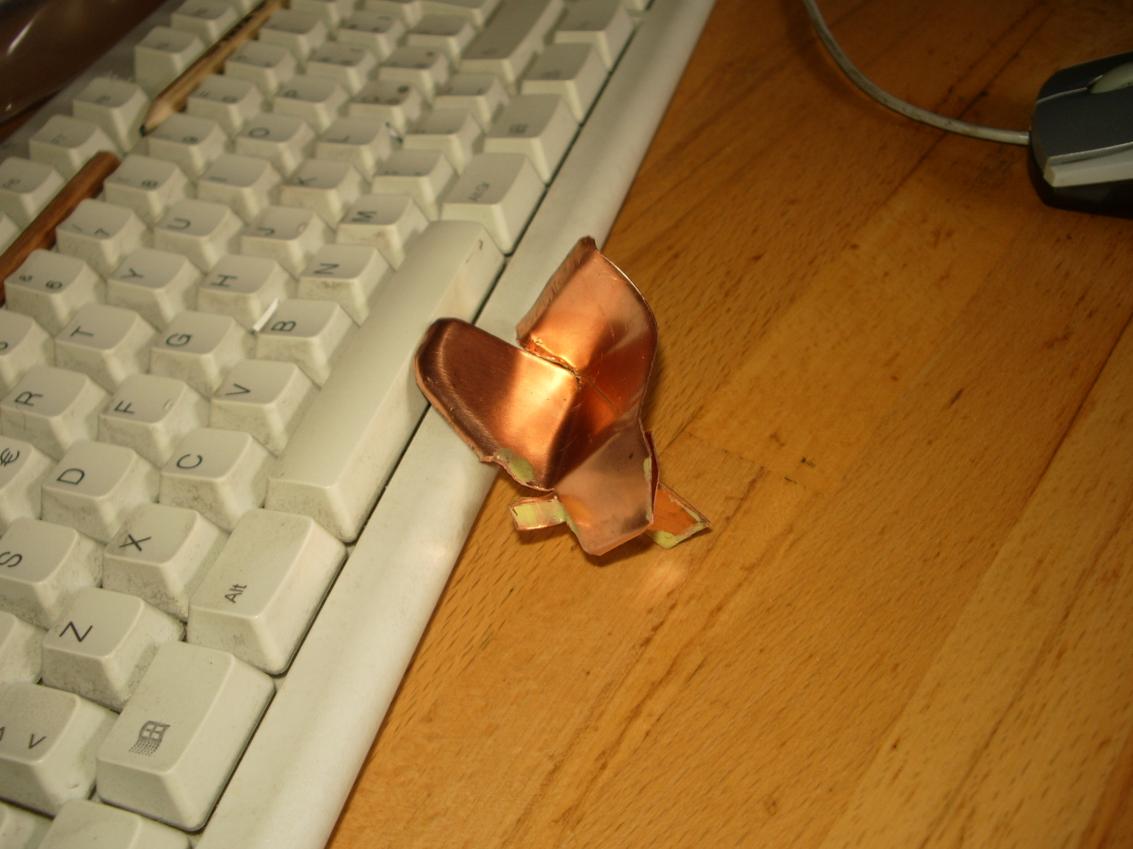

Here my prototype,
IMGP2006.jpgI have decided to work with copper, malleable and easy to chromeIMGP2007.jpgIMGP2008.jpgMODws - 1..jpg and the sketch
for few days I have no access to the doors, Mauro works on them
so I haven't full tested the piece but appear to be good
Cheers
MOD TOP12.jpgsimply painted white primer and chrome sprayed
in situ-
NOW I must test the door look- and the definition of the lip that is screwed to the Door Dust Seal- and conflicts with aluminium door covers

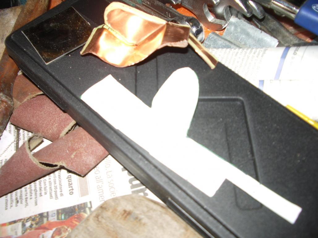

Here the 2nd prototype draft with measurements, in mmprotmod2 - 1.jpgRH or LH side depends from the face worked
after the hammer and gridding work, the RH prototype is ready- difficult is to make the TWO pieces RH and LH equalsMOD TOP17.jpg
not a lot of work just few minutes with hammer on a hard wood piece-
cooper is easy to work and to chrome or also silver plated
NOTE: my measurement can be different for your cars- i have one obscure GAP of 2mm from my shroud and cockpit trim aluminum at RH and LH side-
SO my measurement 25mm can be more large, than normal cars and 23mm can be the right measure
Cheers
NEWs from the MOD prototype -after, I have finished my rear panels. I am noticed that there are not space from my aluminium trim on the door and the finisher plate ( I have hammered (gently)it to permit to my doors will be opened and closed) panelr1.jpg so the prototype is in front of me, waiting a solution
