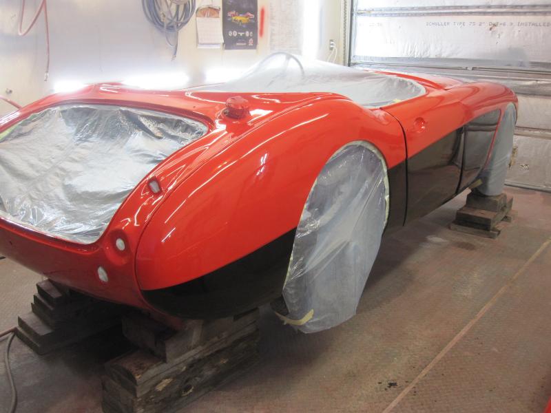

After a few years with little progress on this complete rotisserie restoration, final body work and paint happened this fall. The 1957 100-6 now sports new Colorado Red paint with black coves, as original to this car. The paint turned out well. Now it's time for all the other assembly work.

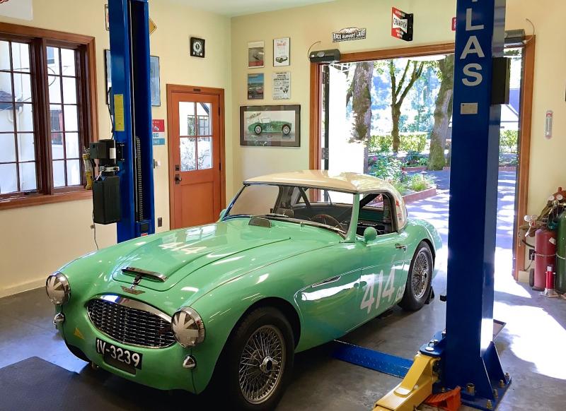

Body color for sure......

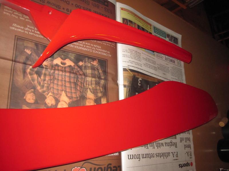

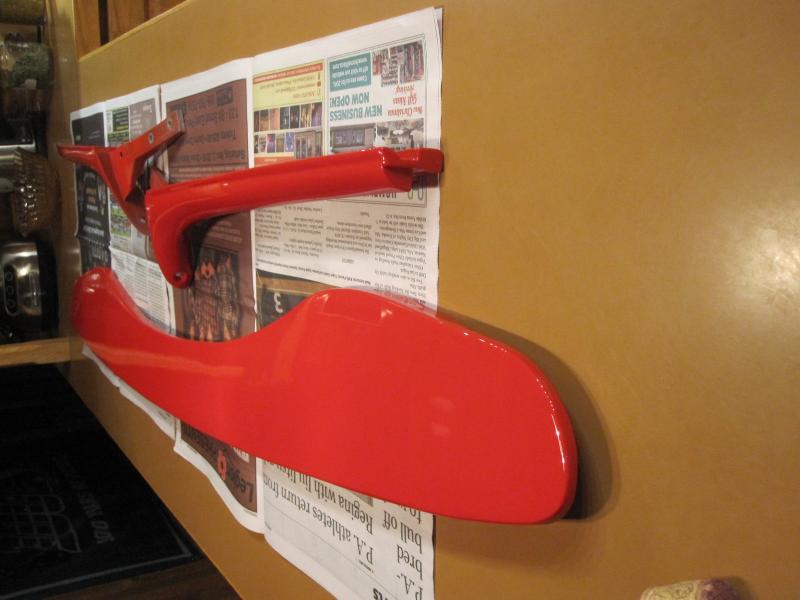

Thanks everyone for helping clear this up. My BT7 also has body color windshield posts, but I recall seeing a discussion thread where some who posted thought that some cars came with the shiny silver posts. Wonder where that idea came from. An image search of the internet also turns up quite a few cars with posts not painted body color. Maybe people like to dress up their cars by polishing the aluminum posts or by having them chromed.
Anyway, the posts now are body color. Just moved them and another valance that needed paint from the paint booth to the house for further curing, so that I could turn down the heat in the booth.
