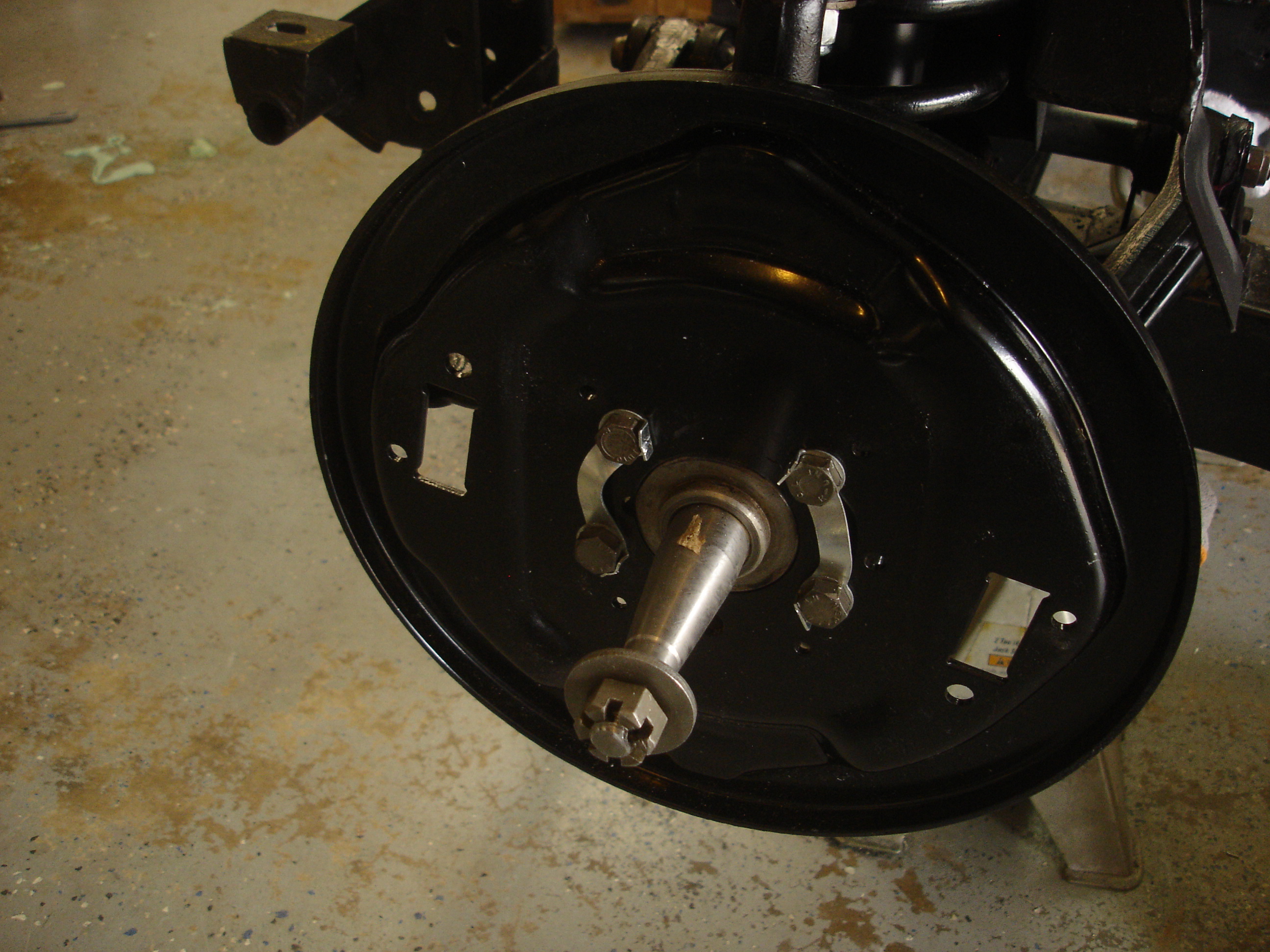

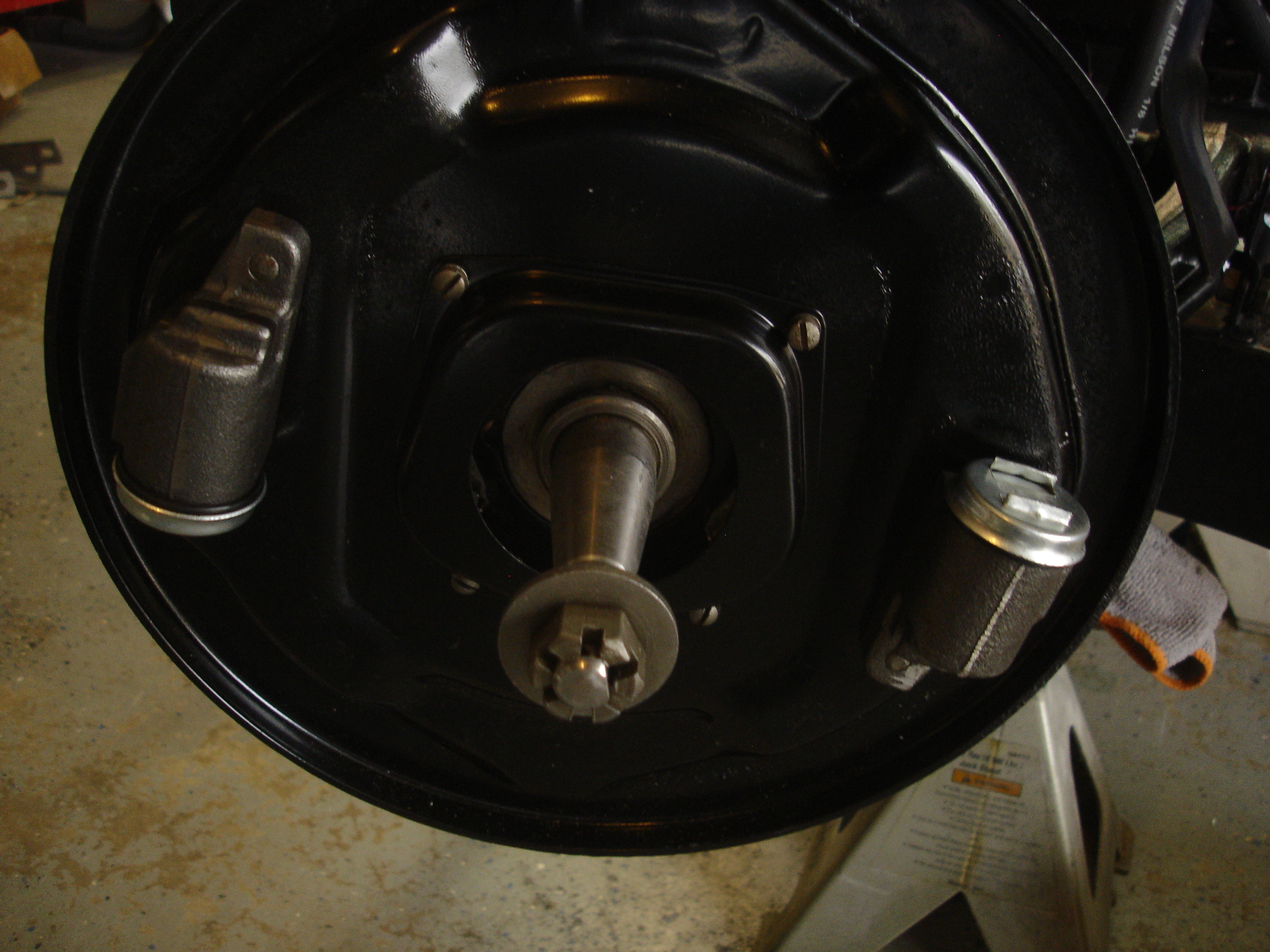

Would anyone have some pictures of a Lockheed front brake system? I forgot to get a picture of the brake-backing plate from behind or one from the front with the shoes and grease catcher removed. I took a lot of pictures but missed these spots. Moreover, when I tried to find a picture anywhere there were none I could find.
The bolting back up for the brake-backing plate is probably straight forward, but I would like a picture to be sure.
Thank you Steve

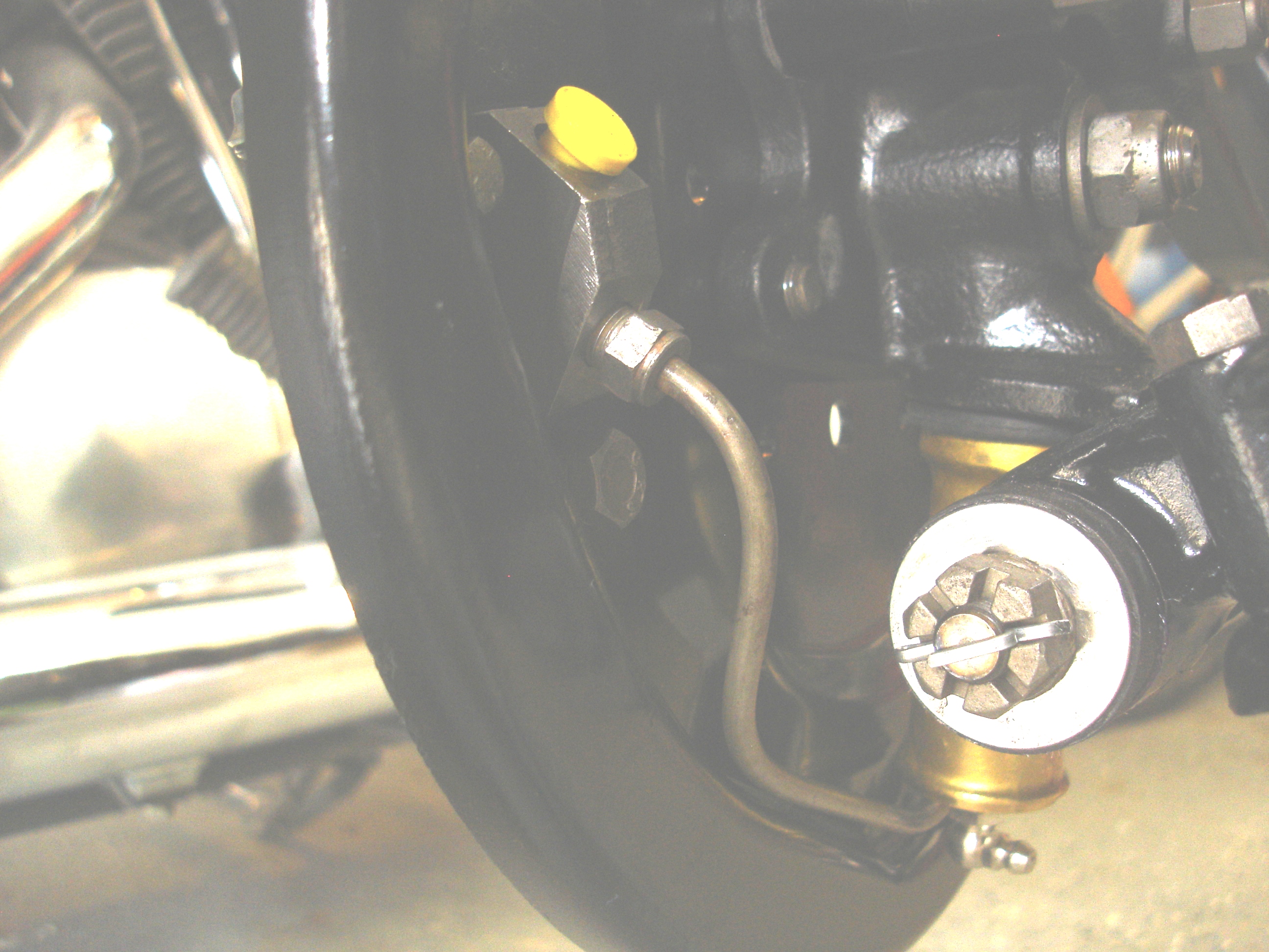

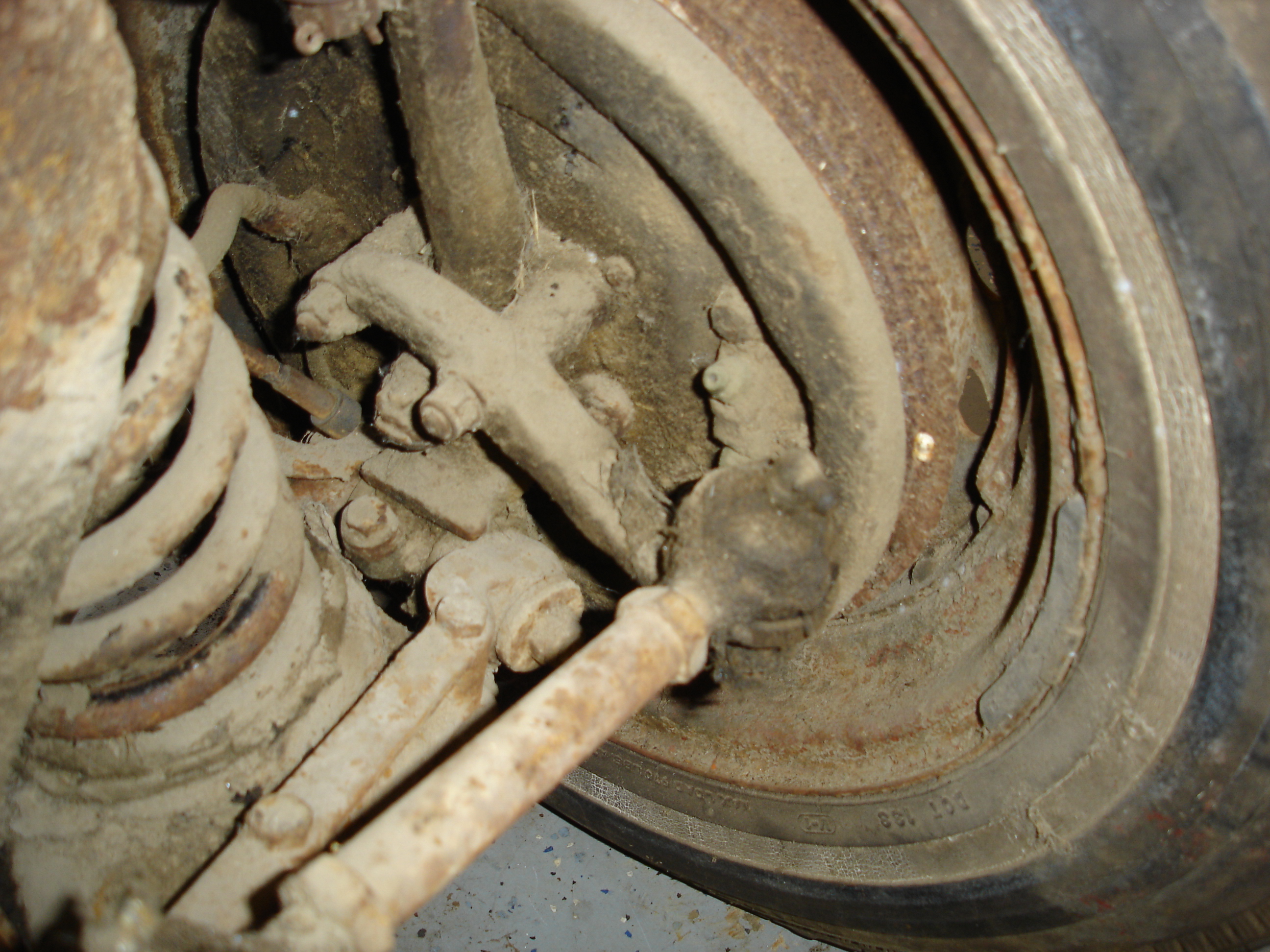

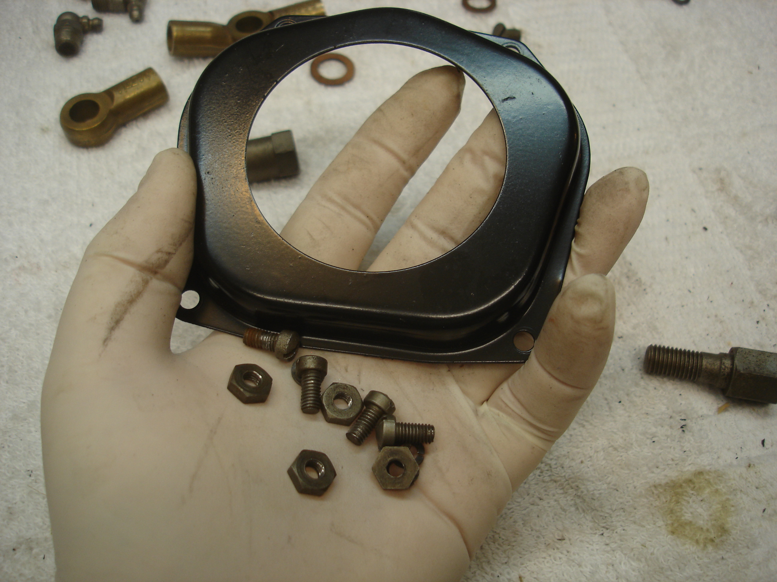

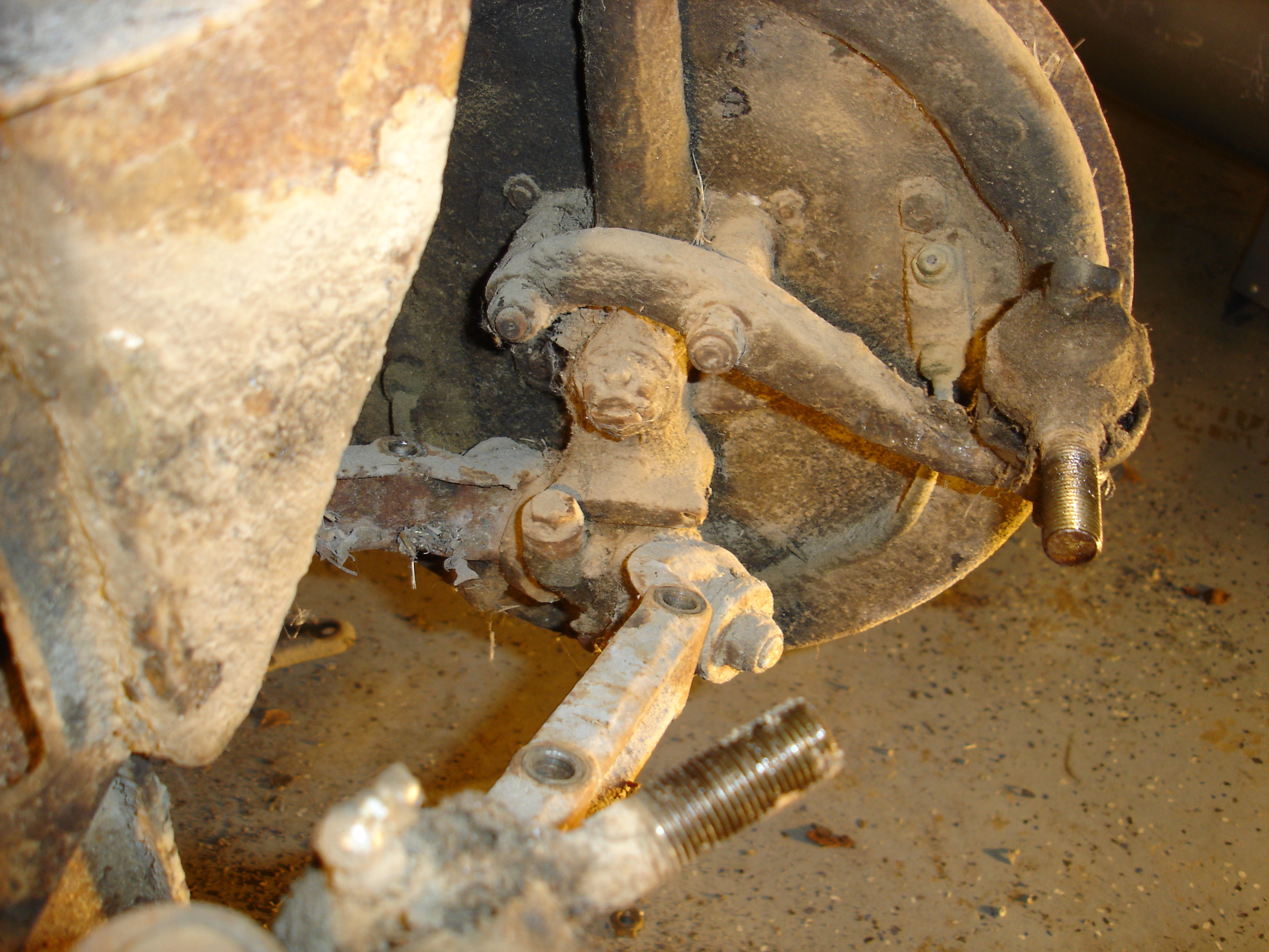

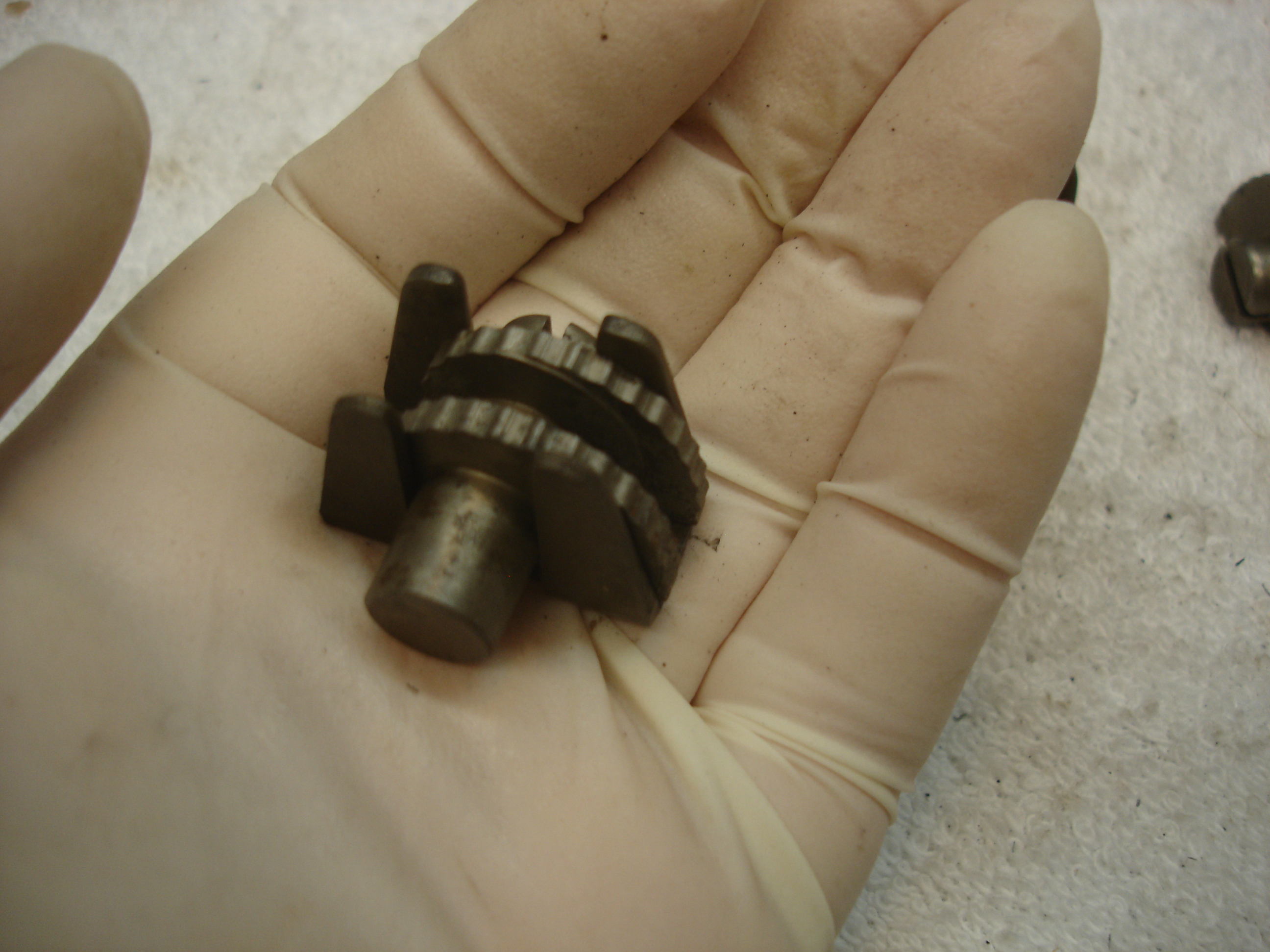

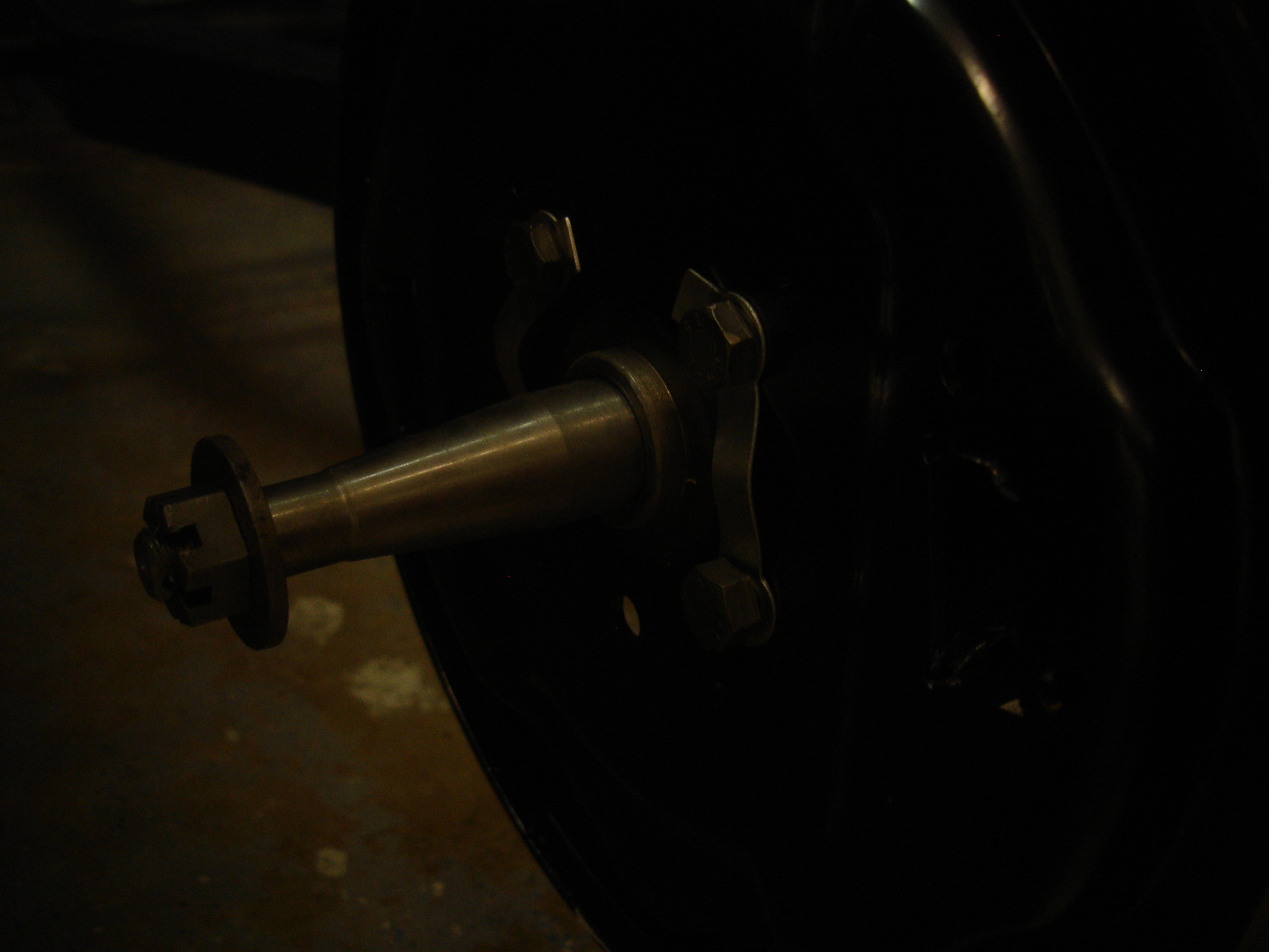

Let me know if the areas you need are too dark and I'll lighten them up before attaching:

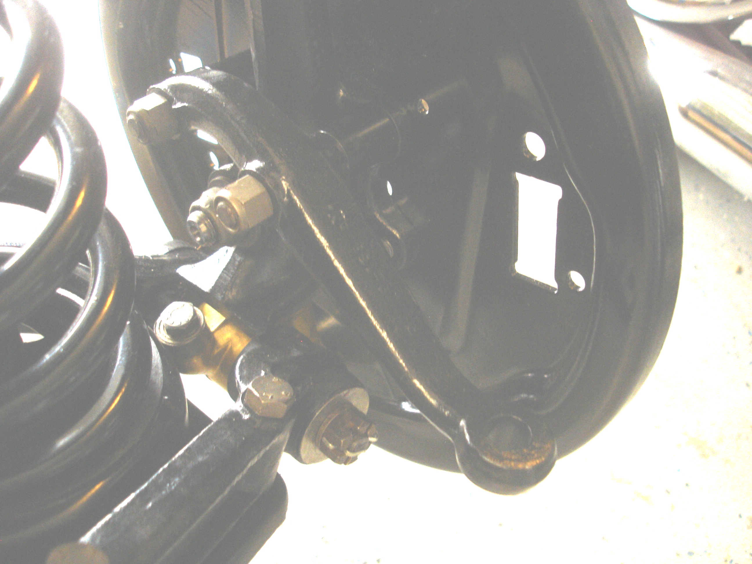

John, great pictures thank you for posting them; your paint job looks perfect.
I needed to swap out the trunnions I initially used because I installed some trunnions that had that 3 degree offset and scratched things up a little.
The trunnions came in this package deal I got on some parts. I did not realize at the time that the 3 degrees offset is made by putting the shaft not in a horizontal position, I thought it meant they were tipped out 3 degrees. Live and learn-- yes they are for a tr4. anyways I have it correct now
