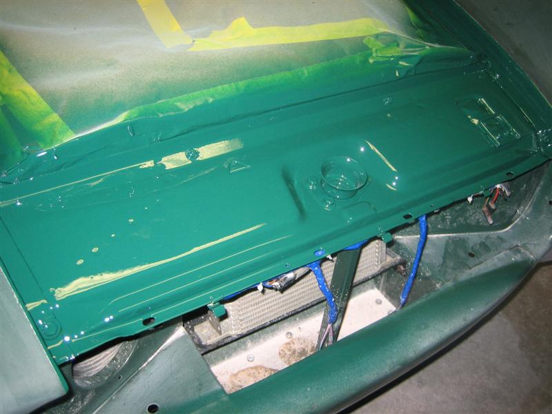

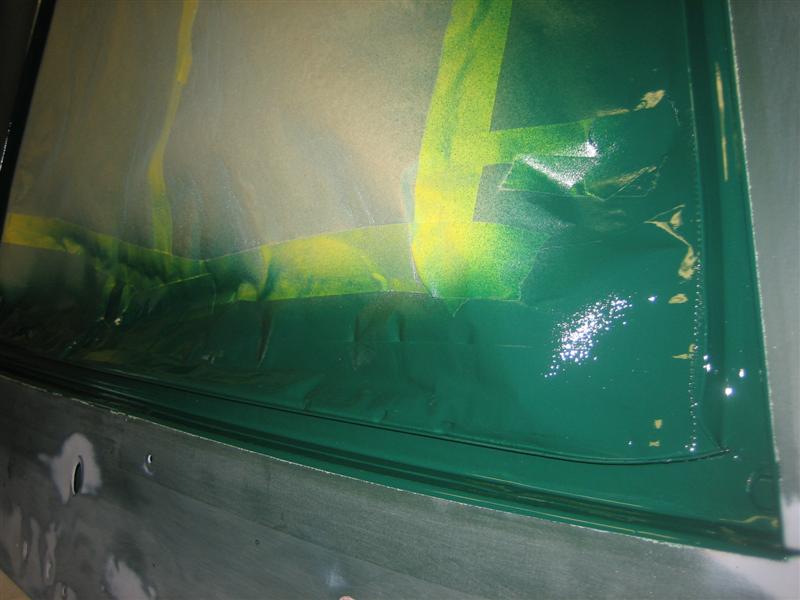

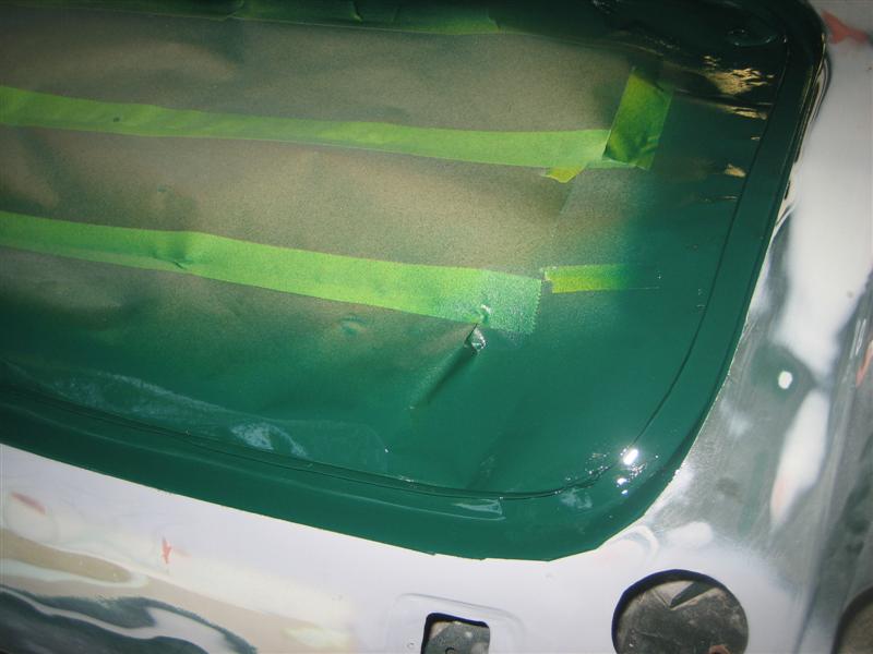

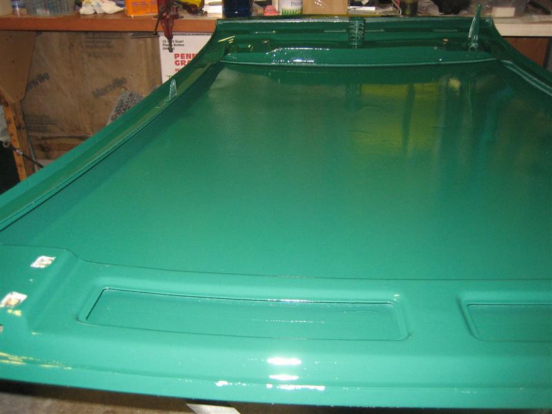

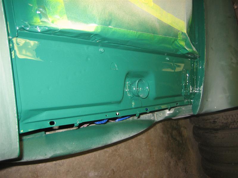

I am finally painting. Started today with the inside of the boot and bonnet and the edges around them on the body. Using Eastwood 2-part urethane base and clear. For the gun I am using their new HVLP Concourse gun, 4cfm at 10psi at the gun. Very little over spray as you can see on the paper.
Tom, 1.2 mm for base and clear?
Hi Trevor, I used a 1.4 mm for both. I held the gun about 5-6 inches off the surface and had no fish-eyes and no orange peal. Next will be the door jambs then a high fill primer which will get a final block sanding then the exterior will finally be painted. This car has been on jack-stands since before our visit 2 years ago. Maybe drive it down for a visit some day.
