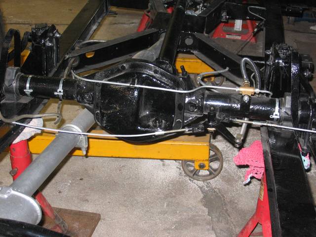

You can see from this photo that the input to the diff is off center.

Don thank you so much for that picture; it shows the brake lines and hold downs perfectly. I really needed that. Don are those metal tie downs from Moss or TRF? They look totally stock. I bought three from Moss last month and they are smaller and thinner than the originals, but they would work. However, I still think they are too thin and do not wrap around enough. I do have some old ones that I could class bead and perhaps I will do that.
Steve
