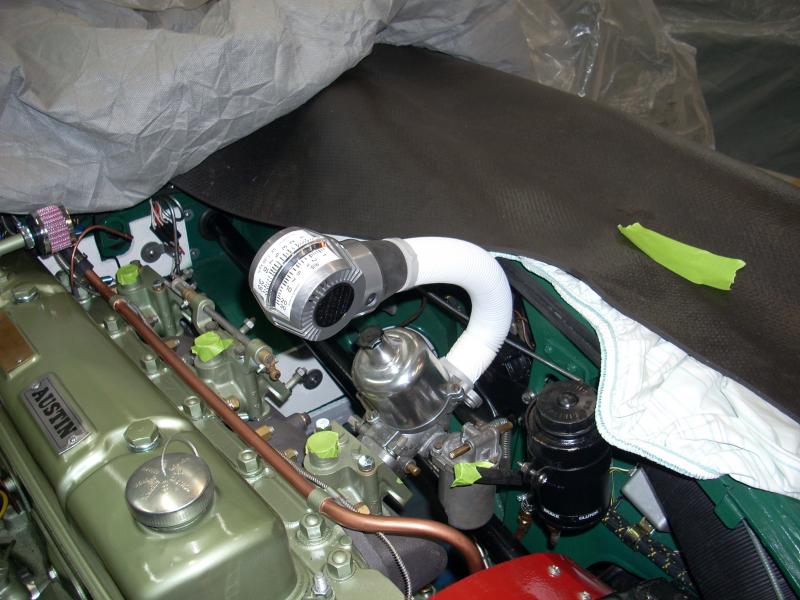

have not tried it under load yet but just sitting it runs very nice. i also had no issue today with any overheating. it runs up to about 180 and stays there. at least during this test day. tomorrow it is back to the float valve and then setting the timing. my hose/gauge worked well on balancing the carbs. i did try the lift to check for mixture and the result shows i am running a little lean. hope to work on that tomorrow as well.

My hose and flow meter. taped the meter to the hose to seal it up. DSCN0415.jpg
