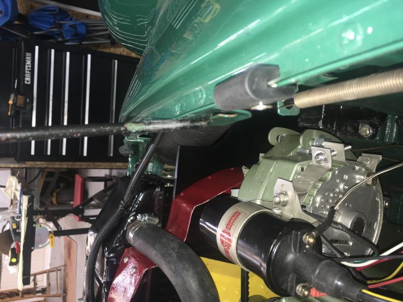

while i had the radiator out i thought it a good time to try a new panel or two as i like to play....
i added two side panels to the radiator to try and fill in some of the gap. i had a shroud (red) i had made so i riveted these panels to the back of them and painted them black. they don't show and not sure they help. but can't hurt i guess.
i also added a scoop under the car. the picture below shows it without the front bumper but i have put it back on now and it does not show. it just bends and goes up to the radiator. see below.
cardboard template.
This goes around the hose and up to the wheel well. then out thru the opening a little right in front of the shock.
another template.
ready for drilling.
not sure these help all that much. i figure at some point i may start eliminating one at a time and see what happens. if it does not help, may as well get rid of it. So these panels plus the extra ones at the top of the factory air deflector are all i am using. Sure looked good today.

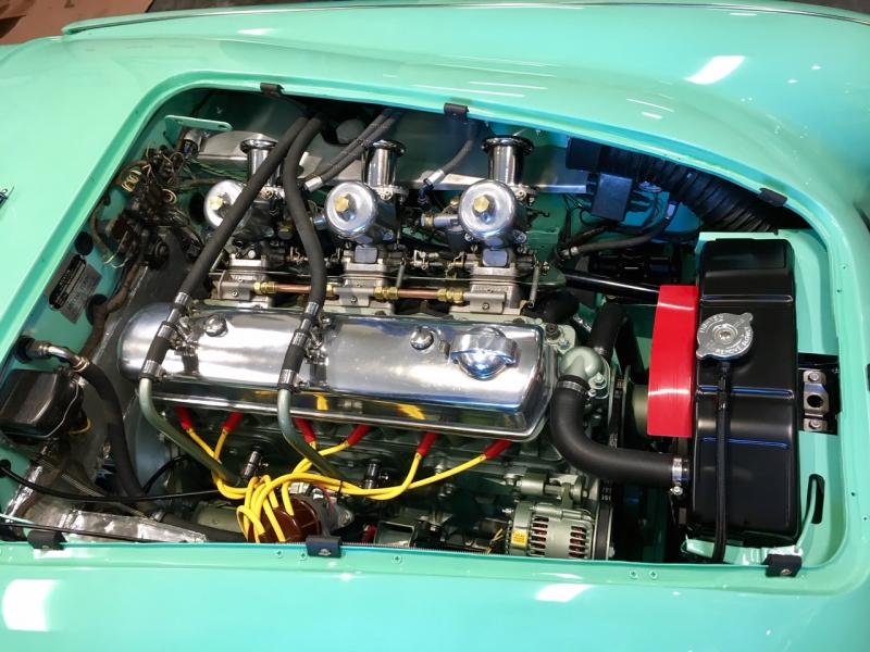

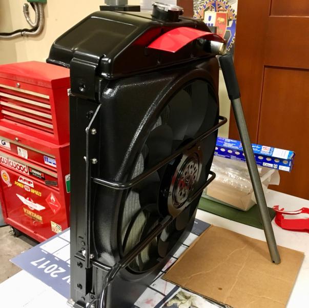

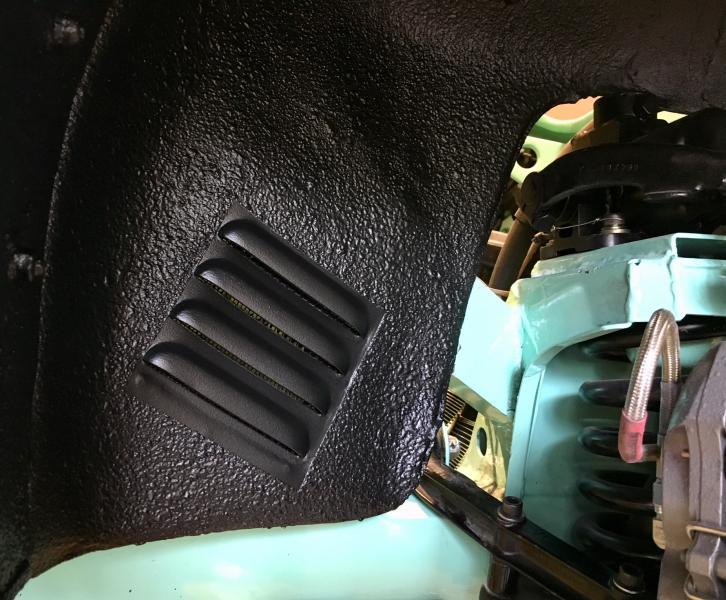

Looks good.....A couple new improvements I made on my vintage racer this season that helped lower under hood temperature in addition to a complete fan shroud were inner fender well vents. NO over heating at all anymore, in fact water temp stayed about 210 even at max performance.

i was walking thru a lumber yard the other day and saw some soffit vents. it got me to thinking about your fender vents. it seemed like a good fit for me since it is not cut in to the outer body. i think lowering the engine compartment temp is always a good thing, especially on the exhaust side.
i was wondering:
how well you figure they work?
the size and placement?
why that size and placement?

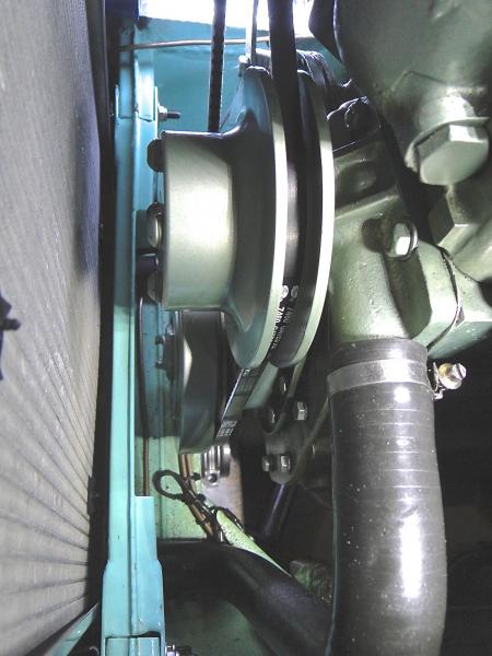

Dougie -
Are you using an electric water pump, or is there room between your fan motor and the stock water pump?
Stock water pump, but I've fabricated custom lower mounting brackets that move the radiator forward and I have a removable lower cross section that is "notched" for the larger racing harmonic balancer.

The vents worked well, they're custom aluminum which I formed into the inner fender well. I had the largest size fabricated that would fit in the area I thought would provide the best flow from the high pressure engine comparment to the lower pressure inner fender well. I didn't want to just butcher up this area, the goal was to provide an original factory apperance. My '65 BJ8 doesn't have the overheating problem, it has a larger radiator core and a texas cooler fan, both do a great job during street driving.

Dougie -

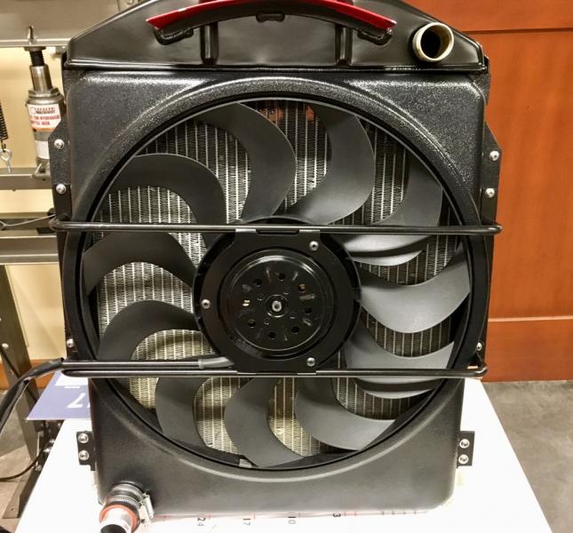

I forget - did you buy your fan and shroud off the shelf, or are they custom made? Enquiring minds want to know (and possibly duplicate).
After a lot of research, I sourced this unit from Cooling Components, https://coolingcomponentsinc.us.com/portal/store/products/cci-1730/
As mentioned, I had to move the lower radiator forward to clear the water pump pulley and fabricate mounting points on the radiator for the shroud to fit tight. When I turn this fan on though, I can feel the air flowing out under the back of the car.....

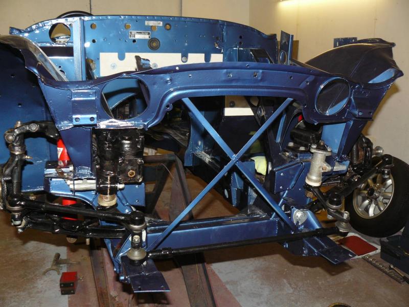

In an earlier post you said: "I have a removable lower cross section that is "notched" for the larger racing harmonic balancer." I have seen a photo of your modification and you clearly did a good job of adding additional bracing to support the modified cross member at the joints.
A number of years ago I was interested in doing something similar. My motivation wasn't racing it was just to make it much easier to get the engine/gearbox in and out of the car. I can't claim the idea as it was prompted by the photos of the car below. Unfortunately, it was too long ago and I don't have notes on who owns this car or why it was done in his case. I enquired a number of places about the wisdom of cutting the cross bar and bolting it in and I could not find a single person, whose opinion I respected, who would support tampering with the cross bar. So, I chickened out as I just did not have the courage to proceed.
I am intrigued to see that you did make your cross bar removable. Are you happy with this modification? Has it now been tested under race conditions? Surely if it is good enough for the race track with the stresses you encounter it would be fine for a road car. I would be very interested in some background on your modification and any follow-up thoughts.

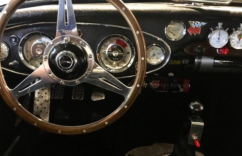

HealeyRick
Thanks for the kind words Lin -

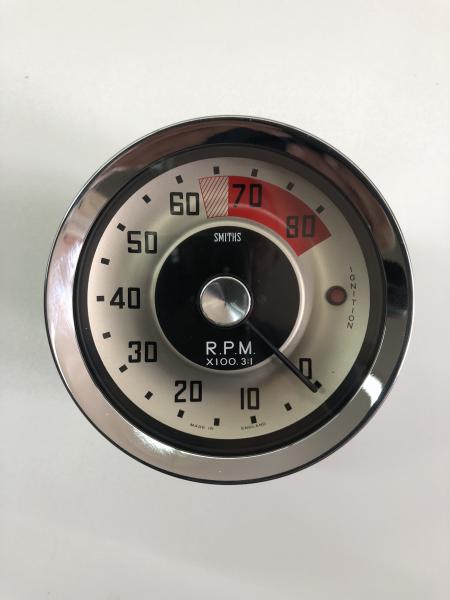

I made a couple interior upgrades this year I think came together pretty good as well. These included a bespoked stock style, "correct gold faced" 8000 RPM electronic race tach, oil temp gauge, and voltage gauge. My vintage racer also lost a few pounds with my "jump seat delete" option.
Like Lin, I always enjoy looking at your car and seeing your latest mods. I'm impressed with your tach and how it looks original. How did you do it? I wanted to be sure my original gauges would work with my Ford motor and used the guts of a Stewie Warner tach inside the original Healey can and face to make it happen. I'd be interested to see your approach. You should be commended for keeping your vintage racer orginal-looking as so many racers have modern gauges, etc, that take away from their presentation.

I made the cross member mod years ago when I first bought my car as most big Healey racers have done this. It make the motor R/R much easier as this is often done a couple times a year. DW Racing makes a ready to install replacement, but they're pretty proud of it. https://www.bighealey.co.uk/austin-...assis/front-yoke-chassis-crossmember-cibp167y
Here's what it looked like with the old radiator installed.

Rick -
Made guages are scratch build solid state electronic units custom build to my specifications. I worked with a master fabricator in Switerland to create them. Completely blew my budget away but well worth it given the quality of the items, no regrets....
