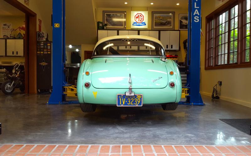

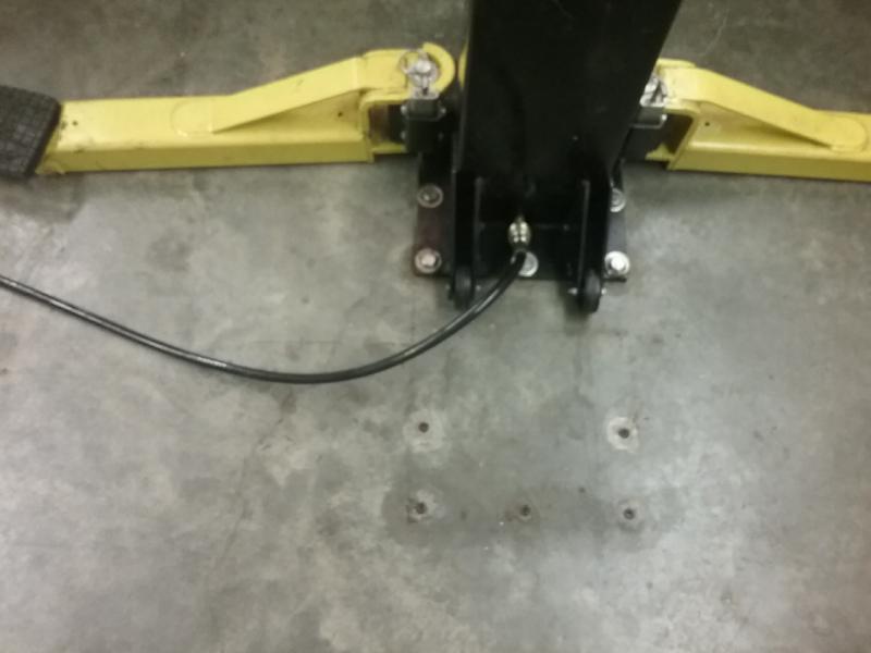

Jack T, Since I am serious about getting a MaxJax, I would be curious how far you spaced your towers for the Healey? Did you have to drill additional anchor holes for your daily drivers?

Yes on the additional holes. Am heading out to the garage later and will get some dimensions and maybe pictures.

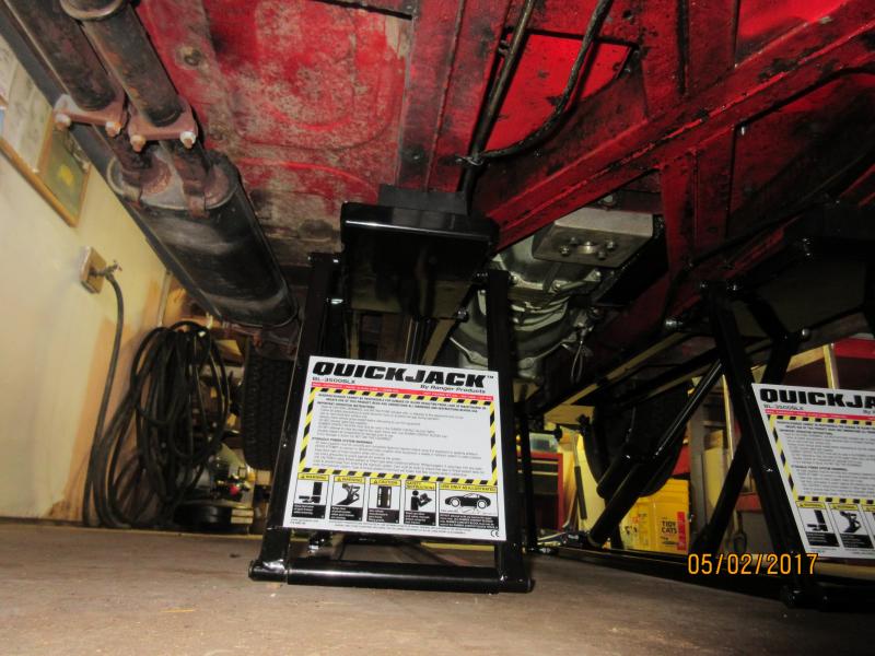

I use the Quikjack, ceiling is about 7' so very limited lift space. Works well in garage. It does move car rearward as it lifts with the rams rising an angle. IMG_3772.jpgIMG_3772.jpg

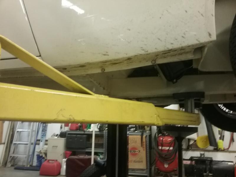

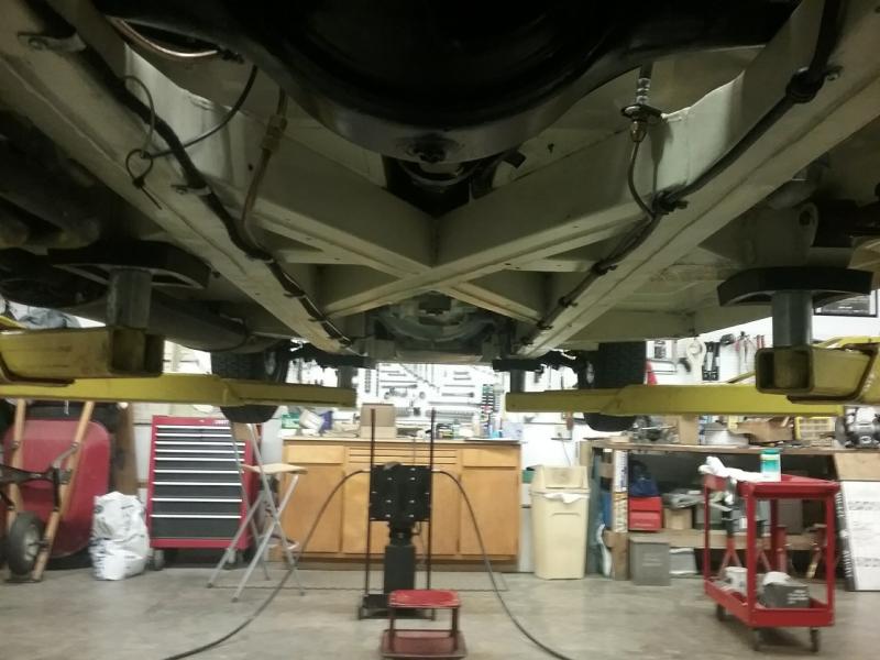

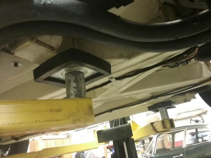

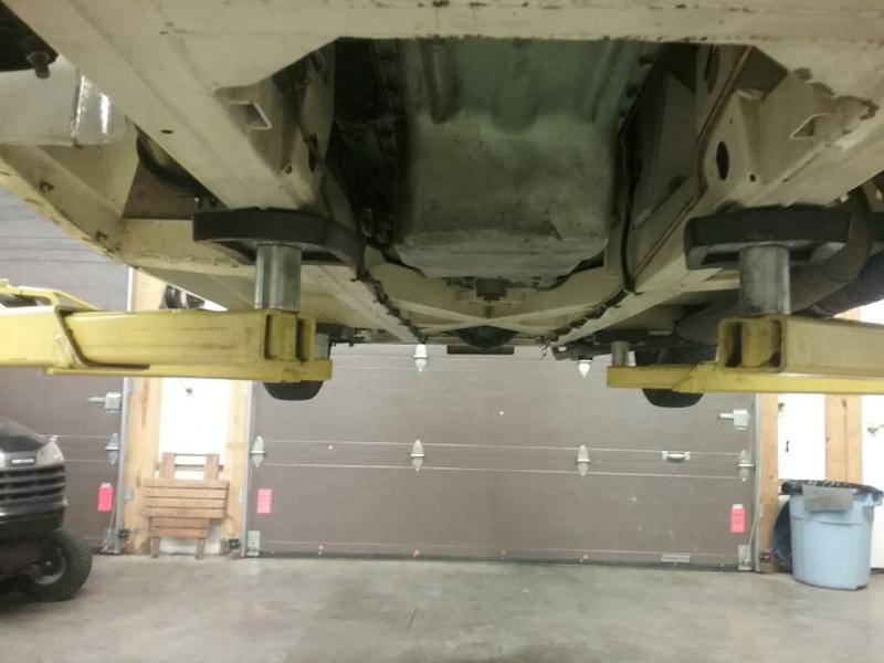

Scot,
The dimension from inside of base plate to inside of base plate is 81" for the Jag and Healey, + 16-1/2" for my everyday cars. I arrived at the 81" primarily for the Jag since I had to reach lift points that are behind the front wheels. I have lifted both cars with the posts at the wider dimension but it leaves a lot of weight forward of the front arms. I like having the front arms as far forward as possible. I use allen-head set screws in the anchors I'm not using to keep the threads clean.
One caveat with the Healey is that I have to use my floor jack in order to get the left side lift arms in position because of the exhaust. Minor inconvenience. The pads end up on the outriggers in the rear and on the frame rails just behind the motor mount gussets in the front.
View attachment 55946View attachment 5594520181016_133048_resized.jpg20181016_133127_resized.jpg20181016_133156_resized.jpg20181016_132022_resized.jpg20181016_144504_resized.jpg
You can determine for yourself where you would like to set the posts. With the MaxJax you can move it around and experiment where the arms will reach before drilling any holes.
Good luck.
