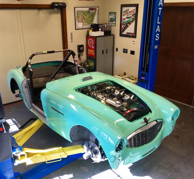

I installed a two-post Atlas unit in the shop/garage I built about 5 years ago. Very happy with it, I went with this brand because they have a warehouse locally and I could save the frieght and just w/c it. Installed very easy and has all the spacers to clear the Healey exhaust. I use it primarily for the maintenance of my vintage racer and not car storage. I needed to be able to service the wheels, brake, suspension, etc directly and didn't think a four post would allow this, plus a four post would have taken up too much space for me.

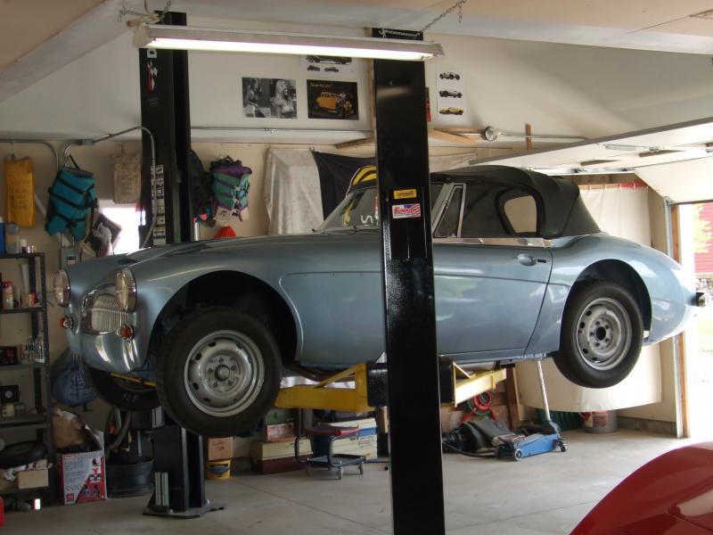

On the left side, I use the body outriggers, but with a couple small blocks of wood so that I'm not lifting on the body-panel's flanges. On the RH side, the arms can reach farther inboard and the pads, while still under the outriggers, are adjacent to the maim frame rails.
This picture shows the Healey on my old "floorplate" lift (equalizing cables/hydraulic hose pass across floor) essentially the same as Dougie's, except mine is branded by Eagle (Chinese manufacture with American cylinders & pump unit).
Looks like in this shot, I was relying primarily on the sills (they're solid, I replaced inner/outer & rockers myself) while fitting an exhaust system.
Since you have the ceiling height, I highly recommend the 2-post with overhead cables/hose (typically 12' minimum ceiling reqd.).
