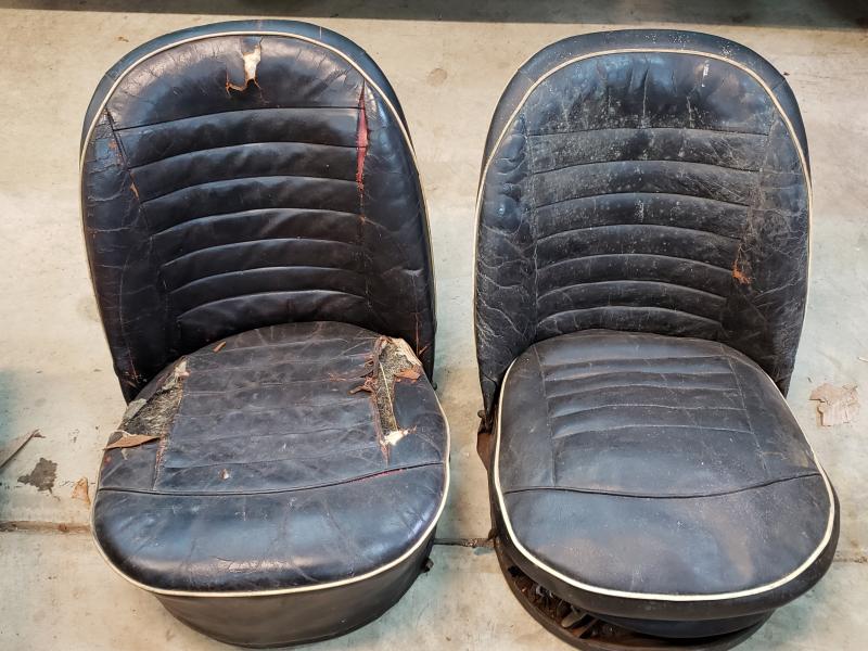

These are the seats as they came to me. Hardware was sitting in the pan. I'm trying to post some pics of the underside of my really bad one but I think the file size is setting me back.
Both plans are in pretty good shape, but not flat. They are both passenger seats but no big deal there. Got some rust, and took a wire wheel to them before it got too cold to work on them. I'd do the sandblast thing, but the wind is howling out here so I'm calling it a day.
Correct me if I'm wrong John but aren't the seats pans supposed to be flat (besides the ridges, that is).
You'd be surprised which one of these has the better springs

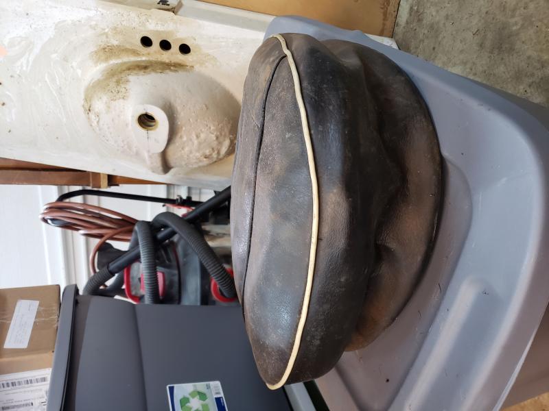

I didn't even bother to clean out the mouse nest.
This is the one with the the torn up cover, after removing it's mouse nest.
Funny how two seats can be so different on the outside yet the worst one looks the best underneath. I'll have to replace one completely eventually if I plan to show, or even sell the car and want top dollar. Honestly, I hope to pass this car down one day. Will I ever show it? Who knows? For now, I can start looking for a good replacement, but not rush. I know where to get recovering kits including springs.

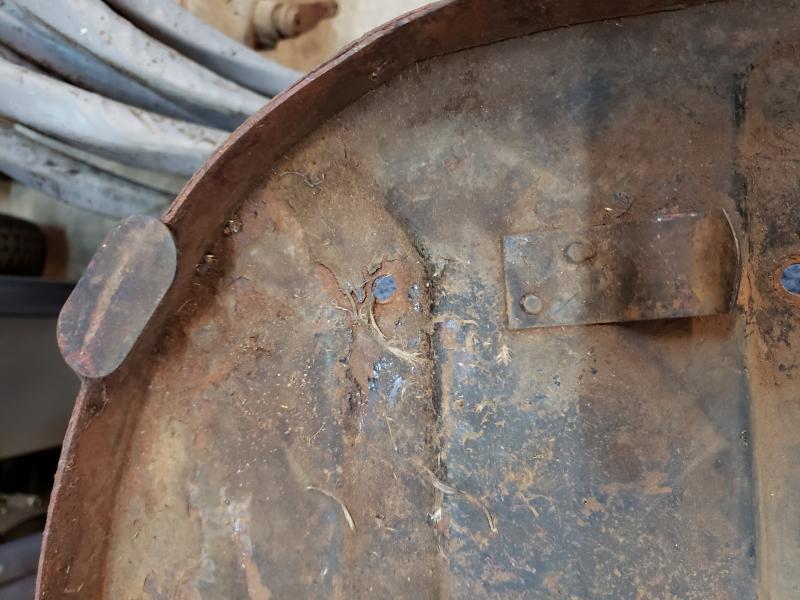

Some more pics. Hope you have a strong stomach.

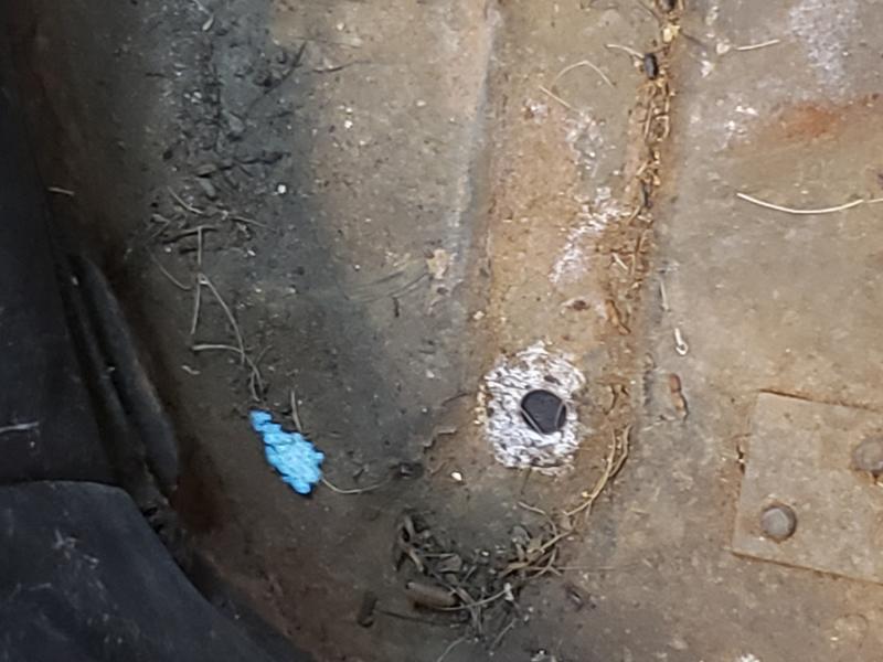

Those shiny black areas are POR15 I think. I couldn't get it off even with a powered wire brush.
Where the shiny was you could see where the black was brushed on, but not where the rust is. I'm thinking whoever put it on, put on enough to cover what was already rusted only, then the rust continued to develop where there was no POR15. I dunno, sounds reasonable. The rust isn't really that bad, all things considered. We have a heavier wire brush that goes on the grinder. As soon as it gets a little warmer, or just not so windy, I'll take that to the pans. Will also need to hammer and dolly them a bit as I think the bottoms need to be flatter (excepting the ridges).
Not much going on except stripping the rust and junk off the seats. Under the "red" paint is a coating that resisted me to no end. Our sandblasting cabinet is too small for the pans by just a little bit, and it was once again too windy to set up outside, but endeavor we will.
I took a heavy-duty wire brush mated to a cut-off grinder (I think that's what it's called) as recommended by dad. It's made by Kobalt and I have to give it props. I used that thing nearly non-stop (except when my hand slipped off the trigger) for over an hour and it never overheated. You know it's cold when you're breathing out steam while your inside your shop.
There was a dark sticky like coating under the red and it too gave me a time until I really bore down on it. After stripping it down to bare metal I went to work with a hammer and the only dolly I had was was looked to be a section of I-beam though not huge (about 7 inches long, top 1.5 inches and bottom 3.5 inches) held in the bench vise (old metal heavy). I first started with just the vice, but it was limiting in what I could pound on so the iron I-beam came out. The narrow top was especially helpful in truing up the bottom of the seat where previous over-sized bottoms bent the pan down right where CJD said the most stress would be, the back set of screws. Unfortunately, I chose a two-pound short handle sledge since the dents/bends looked pretty bad after all that nasty coating was gone. I went gentle though and thought where to land my hammer. My arms are really sore right now. It came out pretty good but still needs some work, and there is a small tear near the rear-most bolt hole. I was pretty careful, but I could have created that, though I don't think so. Welding washers in on Sunday anyhow.
