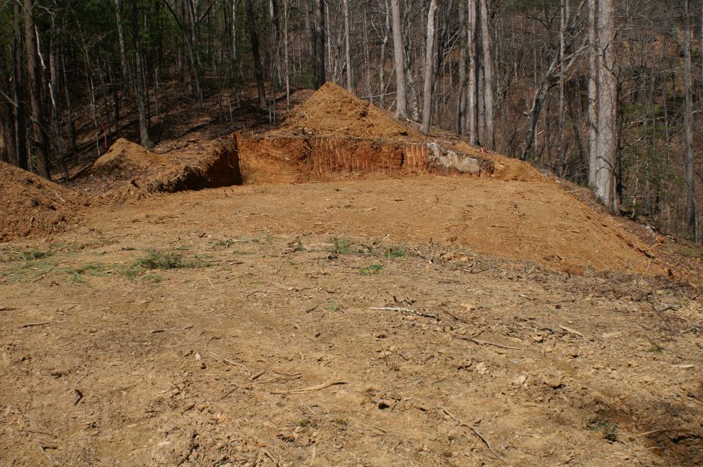

Janet and I just returned from E. Tennessee where we'll be moving in a couple months. The site work is almost complete, and the footers for the garage should be going in this coming week. We're having it built first so we can store a bunch of our stuff, along with the two MG's while the house is being built.
So here's the game: Bearing in mind a pretty tight budget, I'm looking for input on how to equip and design the garage. It'll be a three-bay, 36x28, with three doors and a side man door. Planning on putting peg board on the walls; maybe some sheetrock. The garage will sit back against the cutout area here, three doors across in the picture:

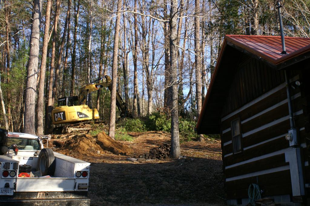

Here's a shot of the property "before", looking up the hill from the existing cabin:

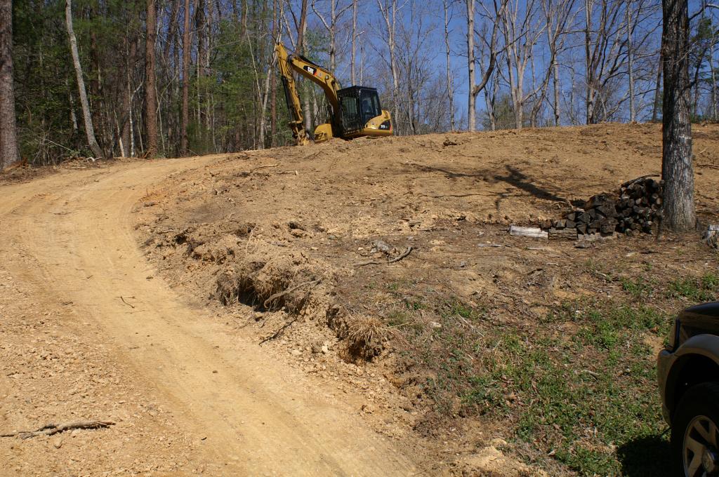

Here's the drive cut in:

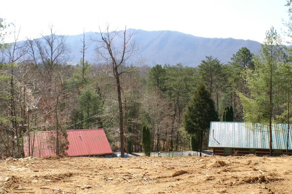

And here's part of the view we'll have:

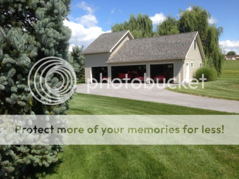

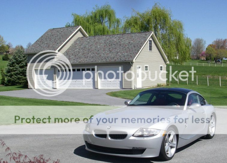

Here's mine built in '06. It's 42 X 28 so very close to your planned size. You'll love that depth for the workbench, tools and whatnot. The one bay has a 14' 6" ceiling for the lift. There's a loft over the other bays for storage. My design was dictated by wanting to match the house (both colors and style). Mickey, There's alot of garages to be looked over on garagejournal.com (and a lot of good ideas).

Are those windows in your garage doors?
From a security stand point I might not have them.... OK, I realize that's just me; don't want anyone peering in, but of course they do let light in.

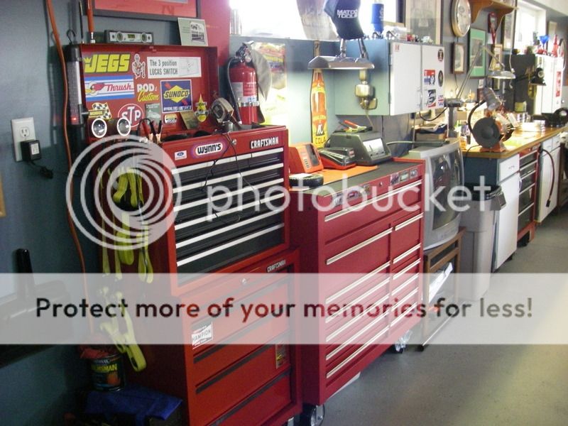

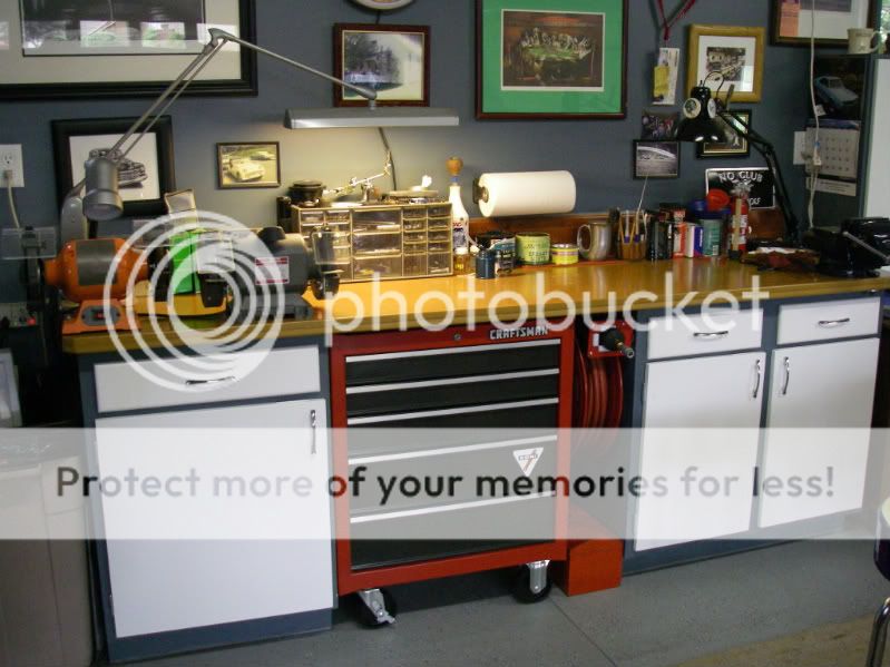

Did my workbench and storage cabinets from someone else's no longer wanted kitchen cupboards.
If you're on the fence about insulation, take my advice and do it before you fill it up. It's no fun hanging out in the garage in winter unless it's able to retain whatever heat you've got.
I put the workbench smack in the middle. Underneath the bench there's a 50" retractable air hose reel.

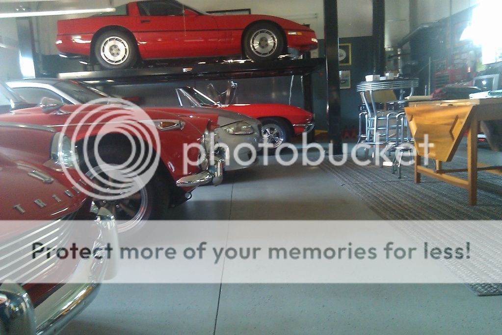

Put in the pub table,TV and poker table. I don't just work in the garage.

Here's some interior photos.

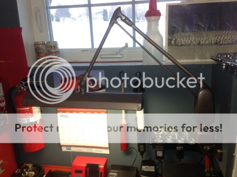

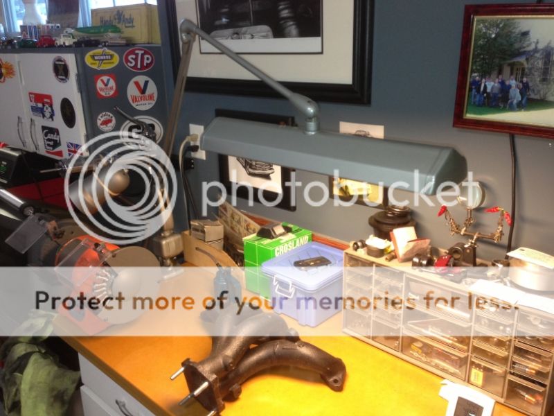

Also, If (like me) you wear glasses, light from above and behind creates a glare and doesn't necessarily help at the work bench. Purchased Dazor "floating arm" draftsman's lights from the 50's/60's/70's off ebay. With patience you can find one for a reasonable price.

Here's photos of my two Dazor lights:
