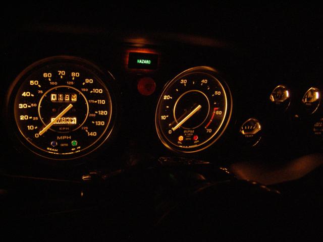

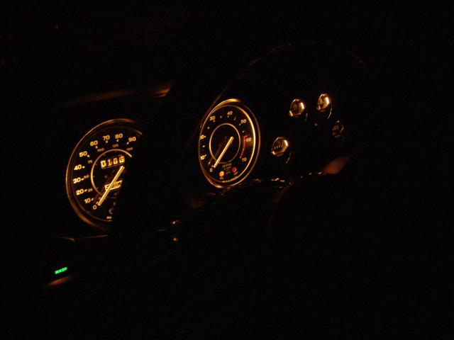

Just two quick pics until my camera batteries recharge. The gauge project came out well. The lights are infinitely brighter than before.
And the dash and new pads look great too, but more on that in the daylight. :yesnod:

Nice job, Paul. I can even see the reflection in the bezels.
Very nice, Paul. I notice in your second shot, the "hazard" light is
glowing brightly. Mine does as well. This made me consider that I
might have gotten one of the lights in the wrong hole or something.
Like I'm going down the road thinking...."HAZARD," and doesn't something
about that just strike as being wrong?
On the other hand, I kinda like it cause it's nice and bright so I've
let it be. I guess with the bad rap....Prince of Darnkness....and all,
anything glowing brightly on the dash was a good thing.
Al,
It was cleaning the gauges, painting the inside of the cases and then new bulbs, with the rheostat that makes them brighter. I just went back to 1974, but with 8 watt bulbs.

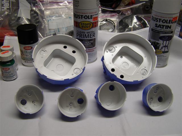

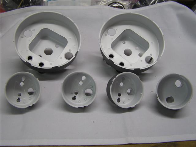

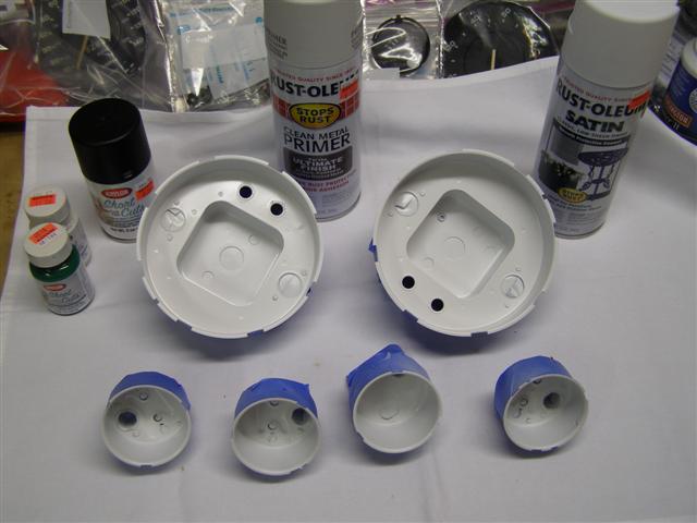

That is correct. There is really not much difference between the new stock bulbs and the 8 watt. The key is painting the inside of the housings and removing the green or blue (on earlier cars) plastic diffusers to allow more light to reflect around in there. No other changes, just the refurbished rheostat.
Just be careful taking the gauges apart. I noticed today when I filled up that my fuel gauge needle is hanging a bit as it moved from 1/4 to full. I must have bent the needle just a bit taking it apart. That's the only tough part.

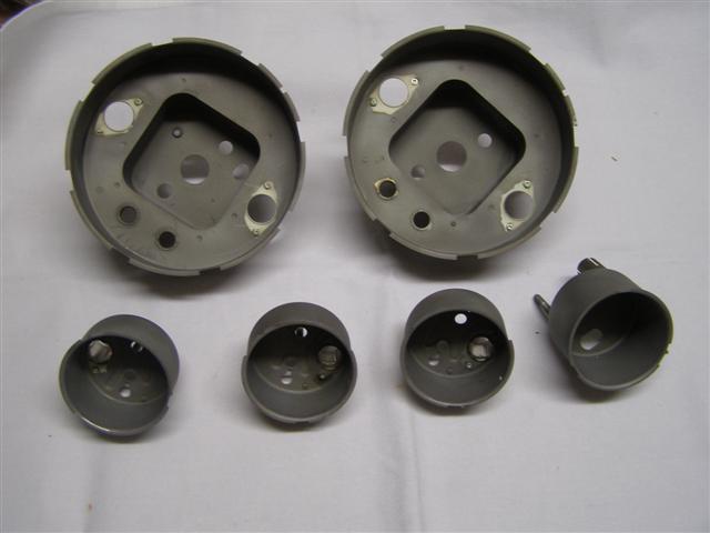

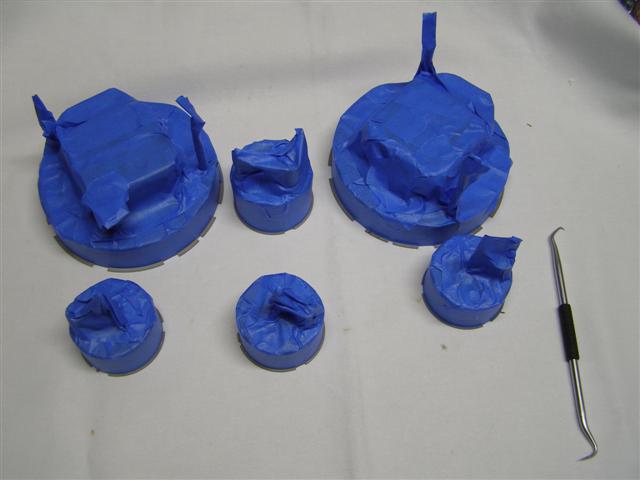

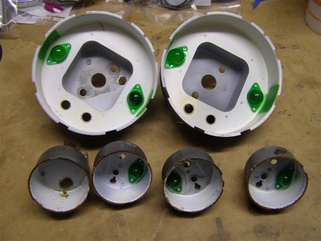

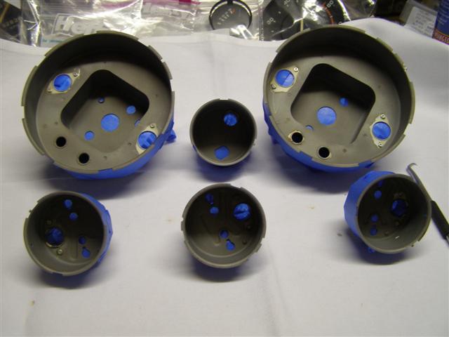

See below. First the original housings, then after being bead blasted, then masked, painted white inside and lastly clear on the backs.
