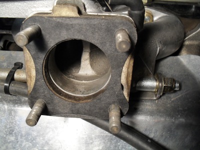

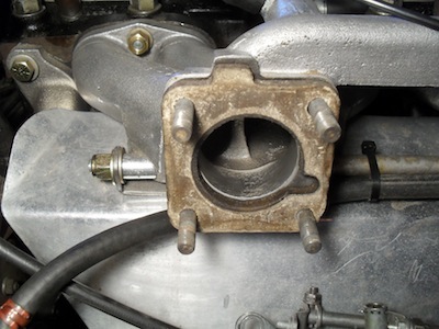

Here's the problem. The intake manifold, the fuel blocks and the carbs have a roughly square shape with a 4 bolt pattern and a 1-3/4" bore right down the center. But in addition, the Stromberg fuel blocks have a machined slot breaking out from the main bore, which I think is meant for an enrichment circuit to dump extra fuel when the choke is applied.

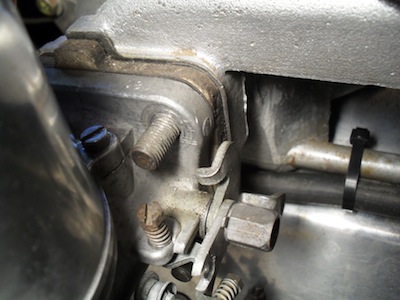

Also, the SUs flanges are not really square, in that the top and bottom sides are flat, but the left and right sides are cut inward in a concave shape.
When fully mounted, the slot in the Stromberg fuel block 'can be' uncovered by the concave edge on the right side of the carburetor, creating a nice vacuum leak. I say, "can be", because there's just enough slop in the bolt patterns to either have no vacuum leak or a pretty healthy vacuum leak depending where the various parts are when they're tightened.
I ended up rotating the gaskets between the fuel blocks and the carbs so there was some extra gasket material covering the leak area, but the right way to fix this is to use the SU fuel blocks, not the Stromberg ones. If you stick with the Stromberg fuel blocks, pay special attention to this possible leak path.
