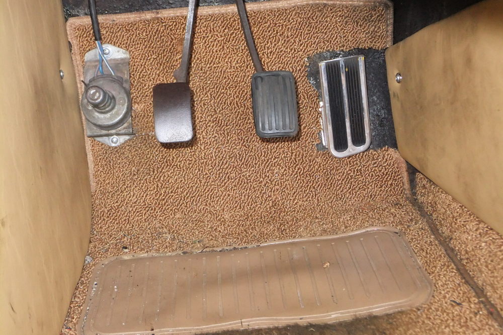

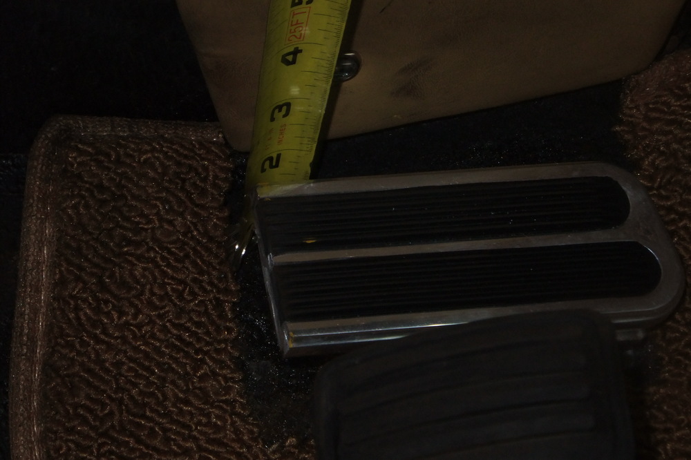

Just got it in last night. All I can say is WOW! What previously took up 7" of real estate now takes 2" (gaining 5" of legroom on this car is incredible).
What I did .....
I had to pull back the carpeting to get to the bare firewall. Using a drill and air saw - cut the dual wall of the firewall for cable access into the engine bay. secured the cable on the outside of the eng bay and ran cable to the Weber. Came with nice mounting & connecting hardware. Fighting some issues with the return spring (so the cable will lower the carb output and inturn lower the gas / RPM's of the engine.
I did have to cut down the pedal - basically the firewall is concave shaped and to get full motion of the Weber (& RPM's) - I had to cut the pedal in half. I'm happy to have it not "look pretty" and pick up an added 1" - 2" of legroom.
